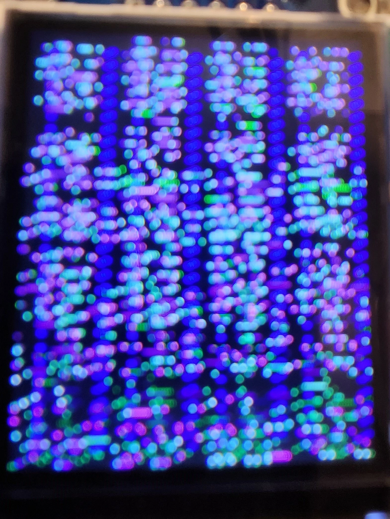

How to transfer buffer to SPI LCD? This isn't it.
I'm really in need of some direction on how to get TouchGFX working on cheap LCD displays.
I'm using a SPI based LCD in a RGB565 format. I've tested the write commands with images, fonts, etc. but TouchGFX is not transferring correctly.
Here is my understanding of the engine and how to use it:
Implemented a flushFrameBuffer method to transfer the buffer to the display:
void TouchGFXHAL::flushFrameBuffer(const touchgfx::Rect& rect)
 // Calling parent implementation of flushFrameBuffer(const touchgfx::Rect& rect).
 // To overwrite the generated implementation, omit call to parent function
 // and implemented needed functionality here.
 // Please note, HAL::flushFrameBuffer(const touchgfx::Rect& rect) must
 // be called to notify the touchgfx framework that flush has been performed.
 // To calculate he start address of rect,
 // use advanceFrameBufferToRect(uint8_t* fbPtr, const touchgfx::Rect& rect)
 // defined in TouchGFXGeneratedHAL.cpp
	uint8_t *fbPtr = reinterpret_cast<uint8_t*>(HAL::frameBuffer0);
	fbPtr += rect.y * lcd().framebufferStride() + rect.x * 2;
	ST7735_TouchFrameBuffer(rect.x, rect.y, rect.width, rect.height, fbPtr);
The engine is being queued every 30ms.
extern "C"
void TE_Handler(void)
	/* VSync has occurred, increment TouchGFX engine vsync counter */
	touchgfx::HAL::getInstance()->vSync();
	/* VSync has occurred, signal TouchGFX engine */
	touchgfx::OSWrappers::signalVSync();
Tried several different ideas on transferring the buffer. From the documentation, I've implemented the following:
void ST7735_TouchFrameBuffer(uint16_t x, uint16_t y, uint16_t w, uint16_t h, const uint16_t *data)
	 __IO uint16_t* ptr;
	 uint32_t height;
	 ST7735_Select();
	 ST7735_SetAddressWindow(x, y, x + w - 1, y + h - 1);
	 for (height = 0; height < h ; height++)
		 ptr = data + x + (height + y) * 128;
		 ST7735_WriteData((uint8_t*) ptr, sizeof(uint16_t) * w);
	 ST7735_Unselect();
And what I get is:

I'm using a single frame buffer. Display resolution is 160 x 128 which is around 40kb for a single frame buffer. I'm working on a L4 MCU that has 96kb of sram. My thinking was that a single frame buffer would be faster and easier to implement. Is that not correct?
40kb frame buffer
SPI bus is 15MHz
Transfer of the whole buffer is less than the timer callback.
MM..1
Jan 22, 2023 9:44 AM UTC
from your data refresh is around 45Hz cca 22ms (for animation) TGFX is based on 60Hz
If you dont use DMA then your MCU do 22ms only SPI transfer
Yes you can use single buffer if used ram is ok. Generate code for custom driver and implement described func in target files. I mean here TGFX too use rect for send data, only diff from partial is , that rect can be full screen.
And in your code primary error i see this
