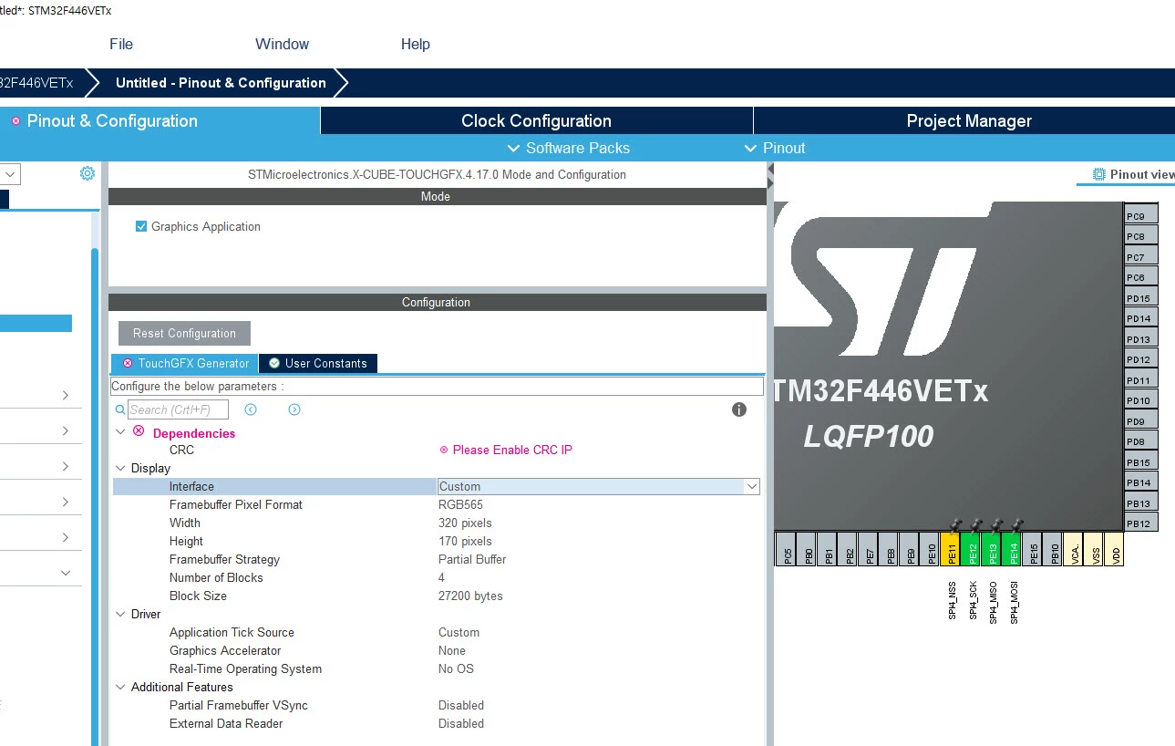

Dear all,
I want to apply touch-gfx gui library on our own board using stm32f446ve and spi-lcd(with st7789v driver ic, 320x170).
Today I tried to generate code through CubeMX(plz refer to the attached picture), but I could not generate without error on CubeMX. Anyway I generated sample codes ignoring errors and tried to compile codes, there were errors. Could someone guide me about how to set up gfx lib on my stm32f446ve-board using spi-lcd?
Best Regards,
Tommy Lim
3 replies
Romain DIELEMAN
September 30, 2021
As you can see in the purple warning, it is mandatory to enable CRC in order to work with TouchGFX. You can set it by going to the "Computing" tab in STM32CubeMX.
/Romain

Thank you for kind answer.
After selecting&activating CRC option, I generated source code and then clicked "ApplicationTemplate.touchgfx.part " file in TouchGFx folder of generated source codes.
It opened Touch GFx designder(4.17.0), I selected UI example and then clicked generated code on the right bottom side of designer tool.
I tried to build source codes using IAR IDE and fixed some path errors. finally I have one error as below.
TouchGFXHAL.cpp
Fatal Error[Pe035]: #error directive: "A user must call touchgfx::startNewTransfer(); once touchgfxDisplayDriverTransmitBlock() has succesfully sent a block." D:\work\446ve_Tgfxt_est\TouchGFX\target\TouchGFXHAL.cpp 35
1 error!
Do you happen to know what cause this symptom?
Best Regards,
Tommy Lim
