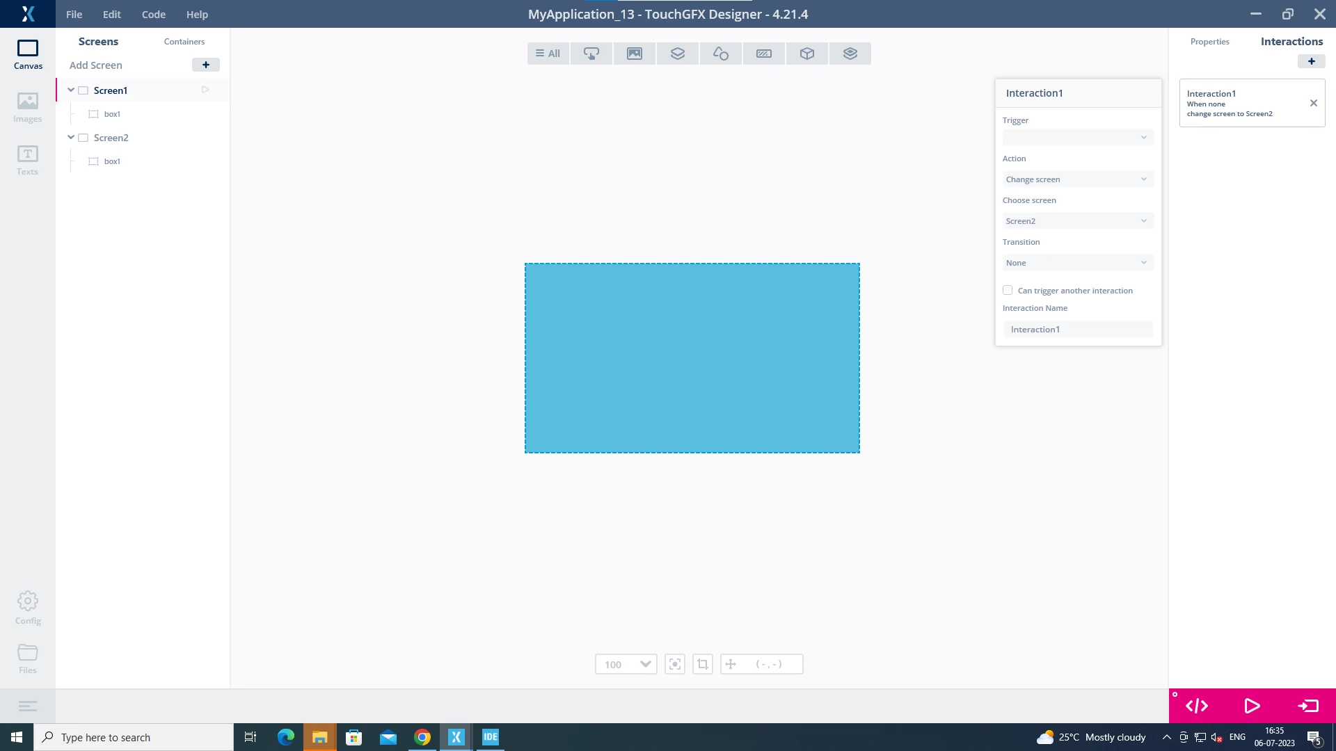

In the Touch GFX Designer, I have taken the total of four screens. In the first screen, I have added a background image to it. Next I have taken a box and added some color to it.
Then I have done same with the other three screens. I have taken box in each screen and filled different colors to the box after adding a background image to the Screen. I also added interactions to change the Screen by wiping and given directions to wipe the every Screen and finally tried to run the simulator, but only the first screen could be able to seen in the simulator and switching the screens is not getting in the simulator.
 Is it possible to change the Screens without adding of buttons? If so, How?

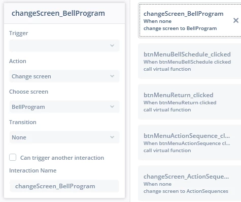

    Senior II
    Jul 3, 2023 6:26 AM UTC
    If the  gotoScreen[...]-functions are not created by TouchGFX Designer, add an Interaction without trigger and action for change screen and then it will:

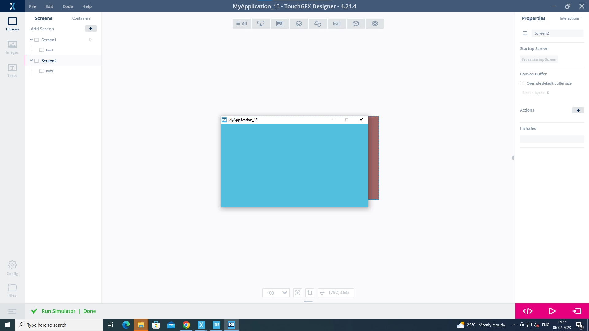

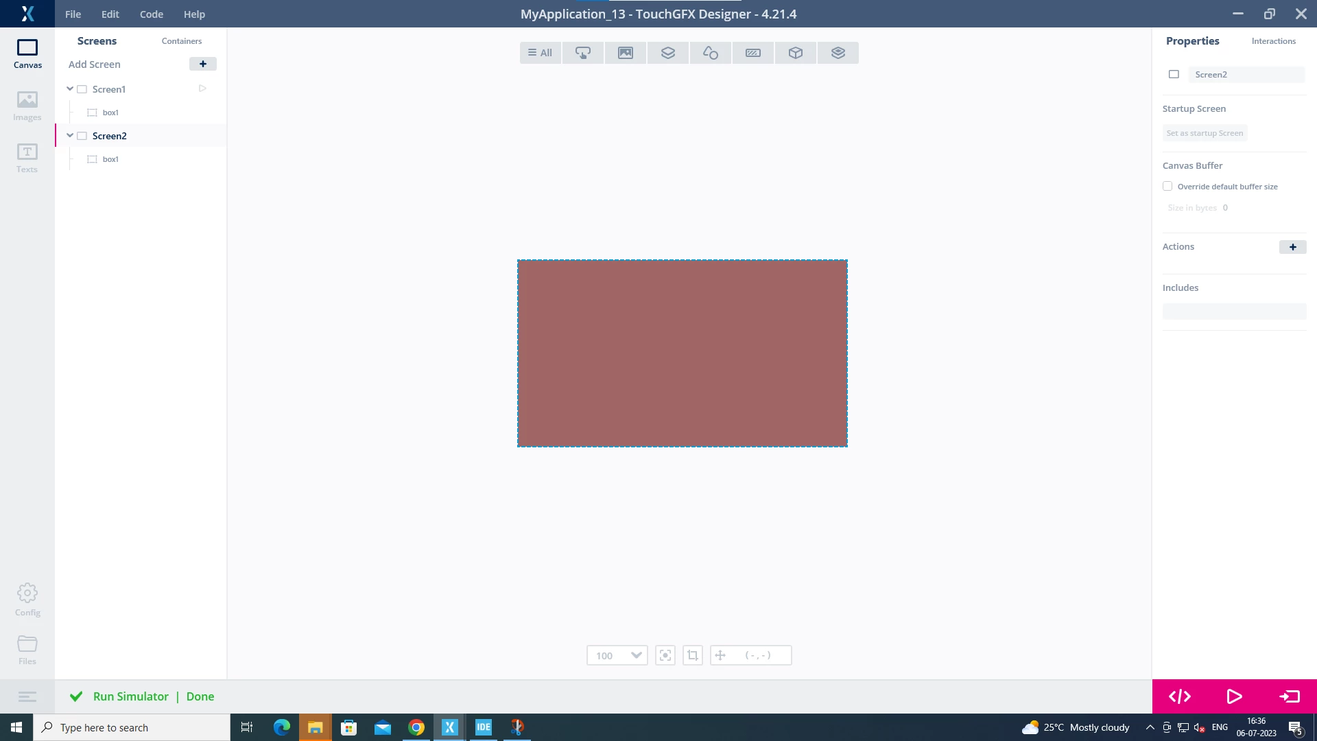

    ShivaniAuthor
    Jul 7, 2023 4:20 AM UTC
    Hello @Osman SOYKURT ,
    As suggested by the @t.decker I have tried with the interactions to change the screens. But the screen is not switching from Screen1 to Screen2.
    When I have tried in the simulation only the box that I have added in the Screen 1 is seen in simulator.
    And I have not added any interactions or actions in Screen2.I have added an action and an interaction suggested by @t.deckerI have added an action and an interaction suggested by @t.deckerscreen2.pngsimulator.png

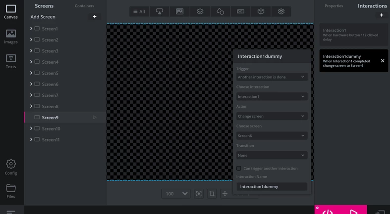

    MM..1
    Jul 7, 2023 6:52 AM UTC
    Hurry up. Start learn howto interractions use. For example create two interractions 1. Delay initiated on screen load
    2. change screen after 1 ends

    Senior II
    Jul 10, 2023 5:55 AM UTC
    Hi @HP_it, you dont need a hidden off-screen Button to get the changescreen-Function generated. Just create an Interaction and let the Trigger unselected.

    MM..1
    Jul 8, 2023 5:41 AM UTC
    And additional info use Delay interraction is good only for intro screens or info , that disapear automatic after defined delay. For control switching screens in normal code you define interraction to hardware button (will virtual dont exist in your design only in code) and if you choice ASCII char for example X , then in simulator you can test it with X on keyboard.
