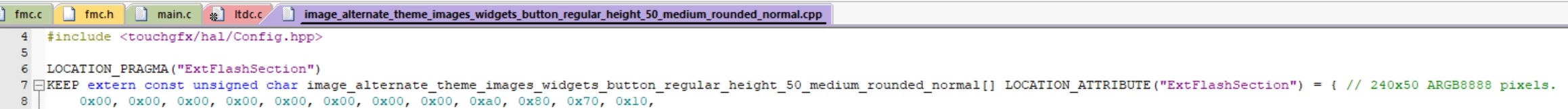

Hi there,
I want to try touchGFX on my homemade board with the STM32F429BIT6 and a band flash chip H27U1G8F2B.

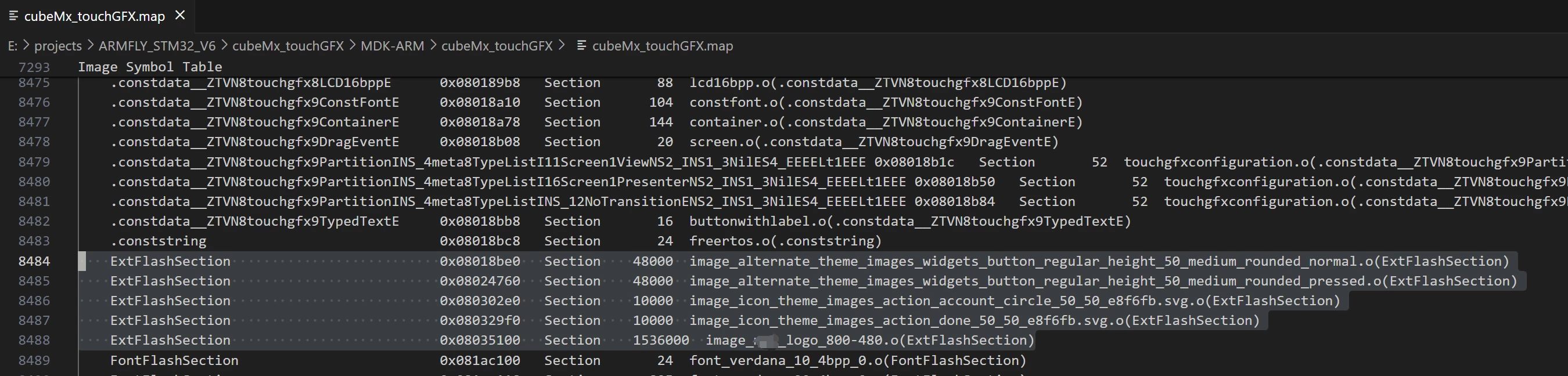

After config by cubeMx and TouchGFX designer, my demo can work as well.
However, I checked the map file and found the image is still stored in the internal flash.

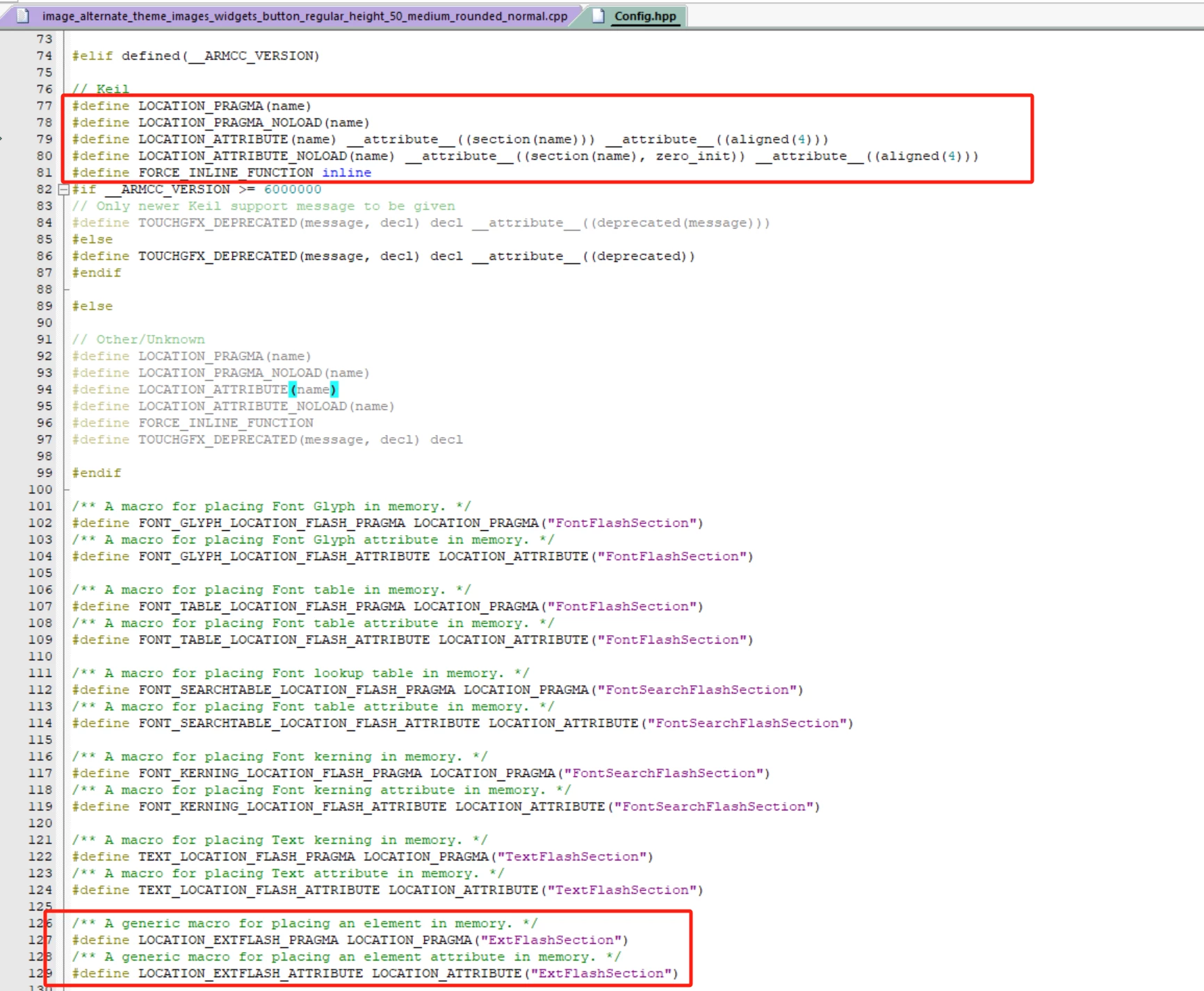

Need I change the "config.hpp" file to complete this function?
How can I restore the data to external NAND flash?
Could this step be done automatically, or need some tools to finish it?
If possible, please give me some documents about it.
Thanks for your help!
no your change be in linker file
two ways external programmer for flash IC or writed loader code GitHub - STMicroelectronics/stm32-external-loader: Provides drivers, examples, loader files and testing routines for external loaders for STM32 series of microcontrollers.
when you configure all right yes load sw is auto, but manege code and objects is manual job
Good examples is TGFX demo projects fer discovery eval boards...

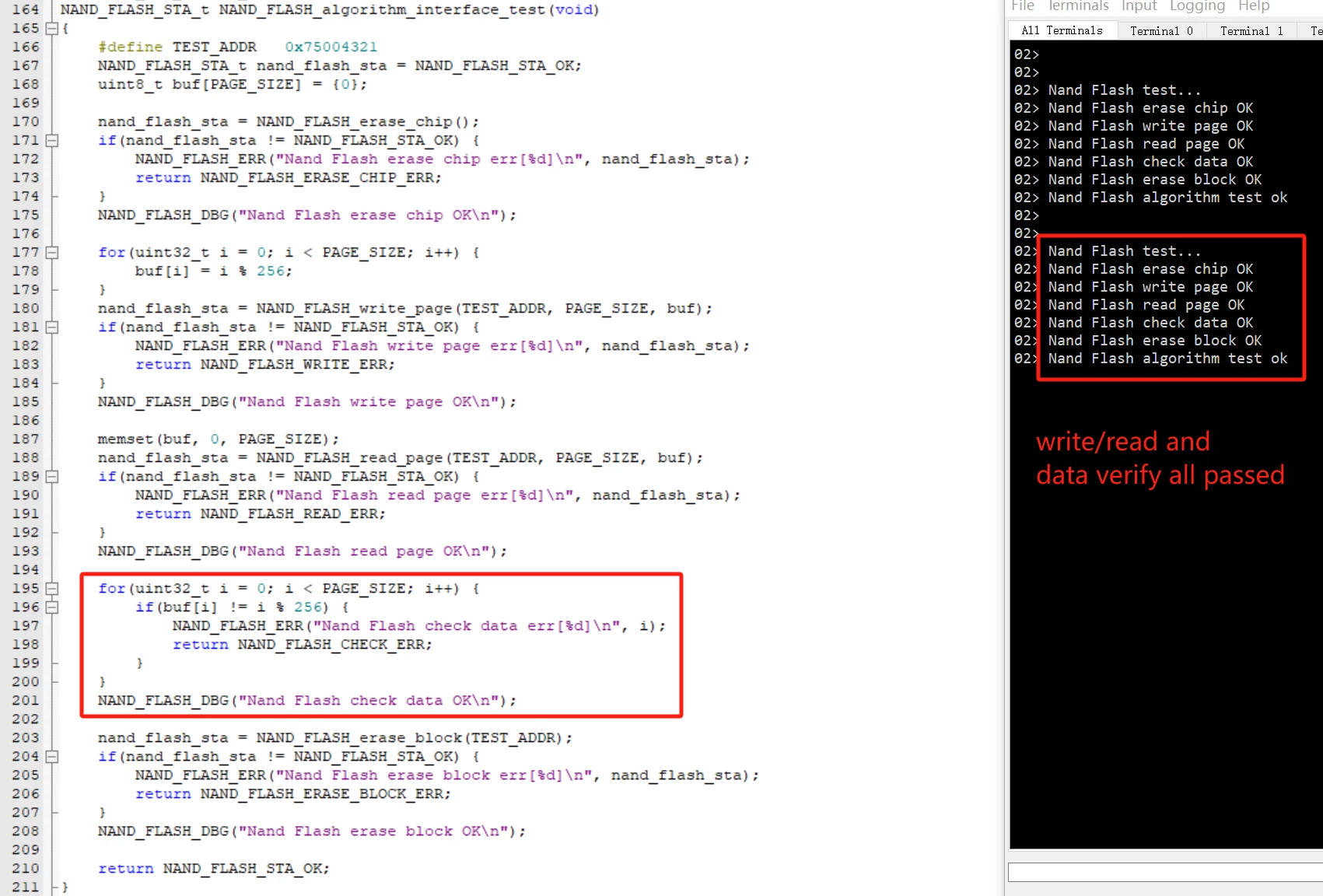

I already checked the map file and the data at 0x70000000.
I also tested the interfaces that are used in FlashPrg.c, seems all the interfaces are passed:
I am helpless because I already tried all the things in my mind.
I want to debug it, but I don't know how.
Do you have any other ideas to check what I am wrong, thanks a lot.

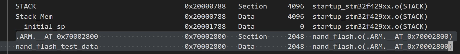

or test as this code(the .sct file can be same with above one, one just delete the last LR_ROM1 part):
#define NAND_FLASH_TEST_DATA_ADDR 0x70003800 // page5
//The "const" is NOT a must, because we already point the addr.
static const uint8_t nand_flash_test_data[PAGE_SIZE] __attribute__((at(NAND_FLASH_TEST_DATA_ADDR))) = {
 0x00, 0x01, 0x02, 0x03, 0x04, 0x05, 0x06, 0x07, 0x08, 0x09, 0x0A, 0x0B, 0x0C, 0x0D, 0x0E, 0x0F,
 0x10, 0x11, 0x12, 0x13, 0x14, 0x15, 0x16, 0x17, 0x18, 0x19, 0x1A, 0x1B, 0x1C, 0x1D, 0x1E, 0x1F,
