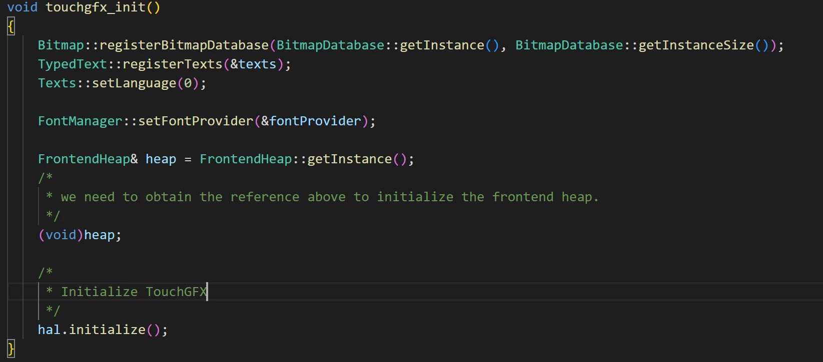

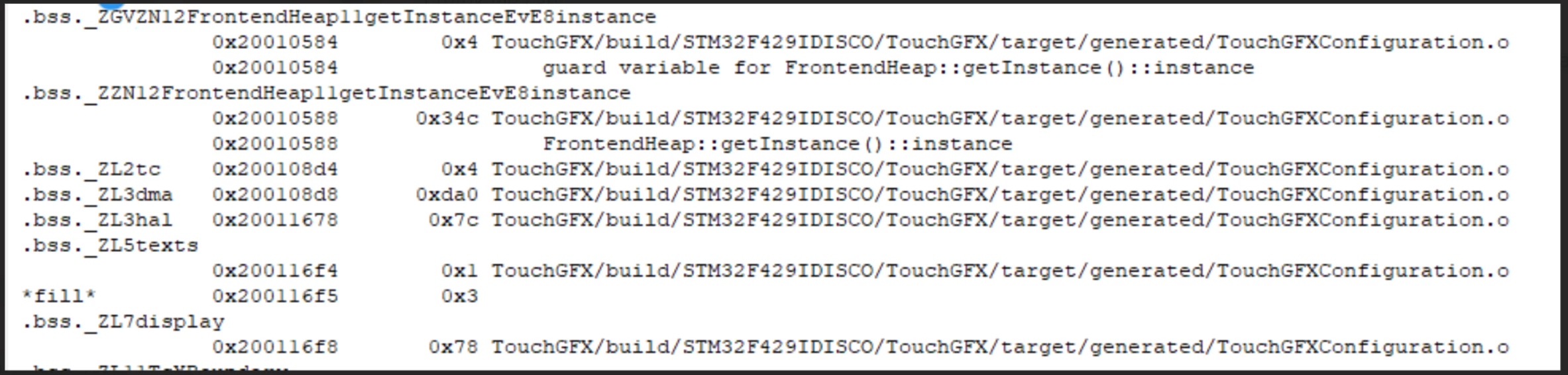

How to store Frontend Heap in external SDRAM?
I want to store this to external SDRAM. Is it possible?
0693W00000WLbw2QAD.pngAnd I put this code to STM32H743ZITX_FLASH.Id

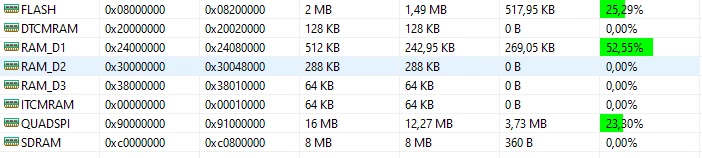

But still Frontend Heap is in internal RAM:

Yoann KLEIN
Jan 3, 2023 2:00 PM UTC
Hello @heyo​,
That should be doable. In the linker script you need to say that data from FrontendHeap should go to SDRAM, like you did. But as FrontendHeap is allocated by TouchGFXConfiguration.cpp, here :
0693W00000Y7INNQA3.png you need to allocate all data from TouchGFXConfiguration.o to SDRAM:
Hope that it helps,
/Yoann

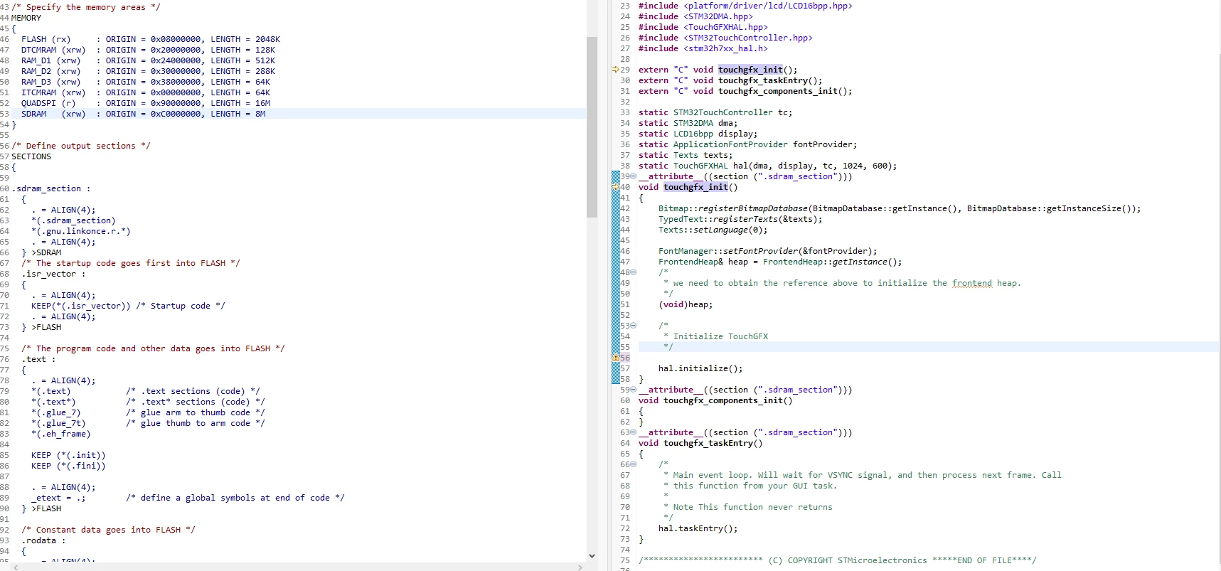

heyo
heyoAuthor
Jan 4, 2023 5:45 AM UTC
Yes, I understand, but don't know how and where to implement. =)
heyo
heyoAuthor
Jan 4, 2023 5:55 AM UTC
@Yoann KLEIN​ I'm trying to do like this but it's not working :0693W00000Y7MDMQA3.png

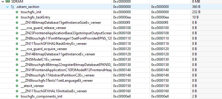

heyo
heyoAuthor
Jan 17, 2023 5:52 AM UTC
I've tried like that, but also does not work :
0693W00000Y8O9TQAV.pngit allocates only 360B:0693W00000Y8O9dQAF.png0693W00000Y8O8TQAV.png

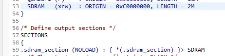

Osman SOYKURT
Feb 6, 2023 9:34 AM UTC
Hello heyo,
Yes it's possible to move FrontendHeap to SDRAM :
In your FrontendHeap.hpp file, declare a new section to use it in the linker script like this :
static FrontendHeap& getInstance()
 __attribute__ ((section (".sdram_section"))) // <--- add this line
 static FrontendHeap instance;
 return instance;
Then in the linkerscript, use it like this :
.sdram_section (NOLOAD) : { *(.sdram_section) }> SDRAM
Note : It will fail if the memory section allocated for it is already used (for the framebuffers storage in SDRAM for example). So to make sure, replace your framebuffer to an other address range in the TouchGFXHAL.cpp file. This is not needed if there's nothing else in SDRAM, only if you allocated your framebuffer.

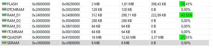

heyo
heyoAuthor
Feb 13, 2023 7:45 AM UTC
@Osman SOYKURT​ It does not start, when I upload code It starts and immediately goes to hardfault and reset(because I add watchdog there).
I change framebuffer range :
heyo
heyoAuthor
Feb 13, 2023 7:47 AM UTC
Hardfault at this point:
