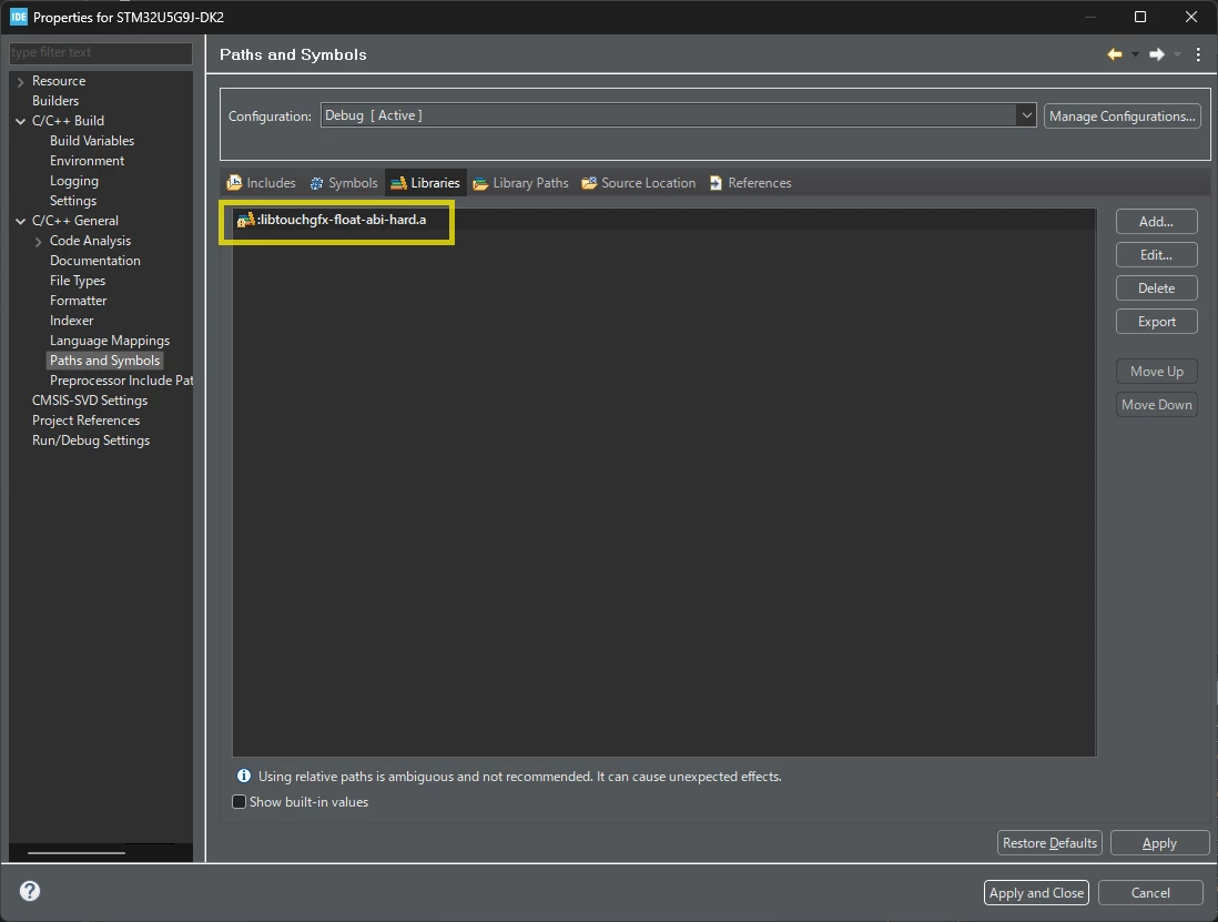

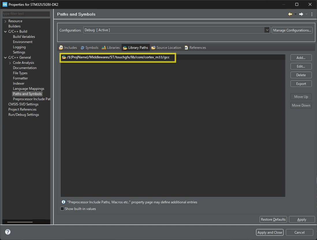

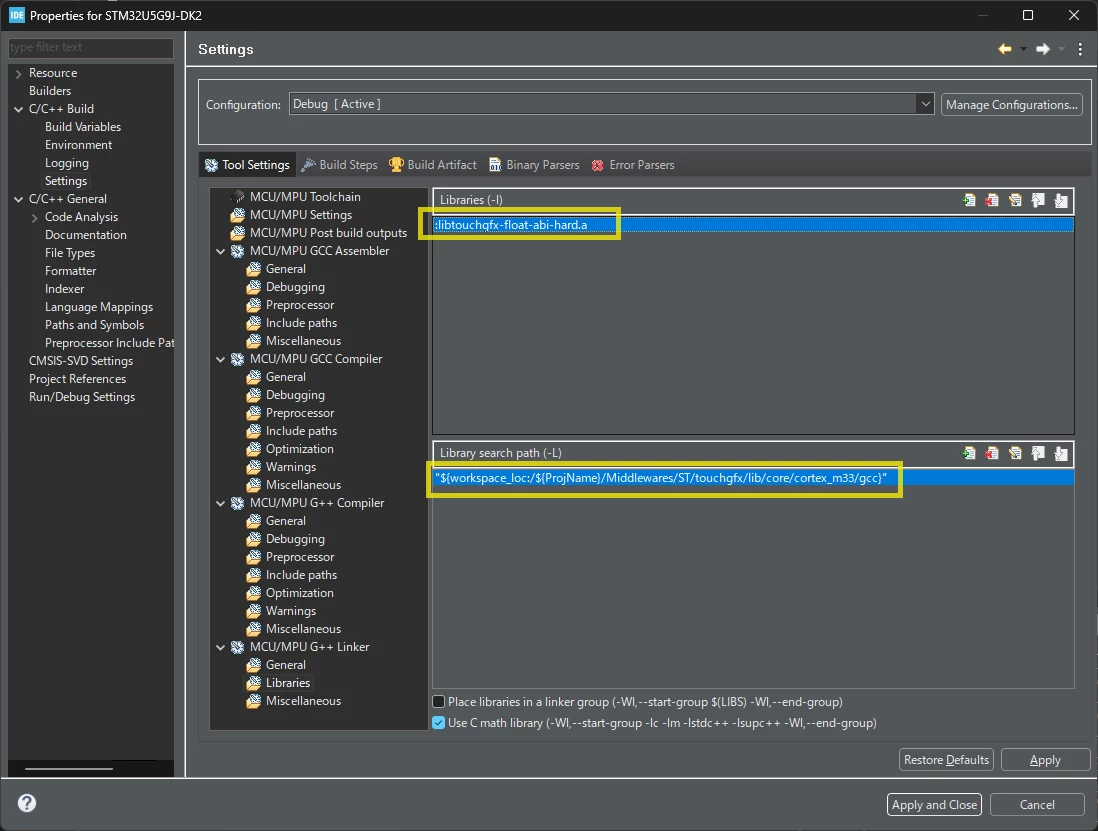

How to solve undefined reference errors during building a project in STM32CubeIDE?
Error message:

You must link with the TouchGFX core library. Depending on your MCU, this would be either
https://support.touchgfx.com/docs/development/ui-development/working-with-touchgfx/using-ides-with-touchgfx
Jul 26, 2024 2:48 PM UTC
Thank you! This solved a similar problem that I was having.
