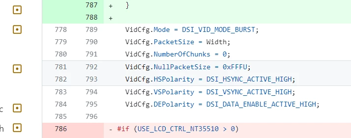

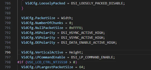

Dear in my repository there are a small difference with your
in your
Line 778 -- 789 -- configure mode burst
in mine
the mode burst in not configured, at least there, so I will add also this line to my version, please take a look in your repository, because maybe other people have same source than me.
Thanks, and I will continue doing the line by line double check
