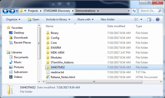

Hello Dimitros,
I am not an expert in graphics, so I am not in the position to guide you how to work with the display step by step. But at least let me provide you a hint.
In the CubeF4 package there is a complete code of demo application for STM32F469 Disco kit, which controls the LCD. You can find it under this path:
...\STM32Cube_FW_F4_V1.16.0\Projects\STM32469I-Discovery\Demonstrations
Among few supported toolchains you can find also a project for AC6 SW4STM32:

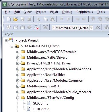

If you open the project, you can navigate through it and find some libraries responsible for LCD, for example LCDConf.c:
I hope this information will be helpful to you.

Dimitrios Bako
Jul 31, 2017 12:19 PM UTC
Posted on July 31, 2017 at 12:19
Hello Szymon,
I have already downloaded the CubeF4 package but it seemed quite difficult to extract the necessary configurations for the LCD to work.
Nevertheless, I gave it a try with no luck!
