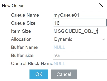

So i just looked at your other thread. You should follow this example https://www.keil.com/pack/doc/CMSIS/RTOS2/html/group__CMSIS__RTOS__Message.html#gaa515fc8b956f721a8f72b2c505813bfc
And for the queue you would set it up like this
Hope that helps.
