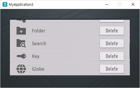

I am creating my menu using ListLayout Example of TouchGFX example code.
I want to set the Limit of the Scrollbar. But when I reviewed the current example and Class, I could not find that part.
How can I set Limit ?????
The end of the current list is similar to the one below, but I want to make the end of the list like the second one.
2nd.

Its like the scrolling limit value is somehow set to the upper side of the container instead of the lower side
Martin KJELDSEN
Principal III
May 7, 2019
The height of the "list" member in the ListView example controls this behavior. Try, in your concrete view constructor, adding the following line:
list.setPosition(0, 0, 250, 50 /*Previously 250*/);

Here is the answer for the question.
Simply use
setWindowSize()
From ScrollList Class.
If you have a list instance called myScrollList. And you want it to always display 5 items. You do this:
myScrollList.setWindowSize(5);
The default value is 1. So it will keep scrolling until there is 1 item displayed (Like the screenshot you shared). Set it to 5 and it won't scroll if less than 5 items are going to be visible.
