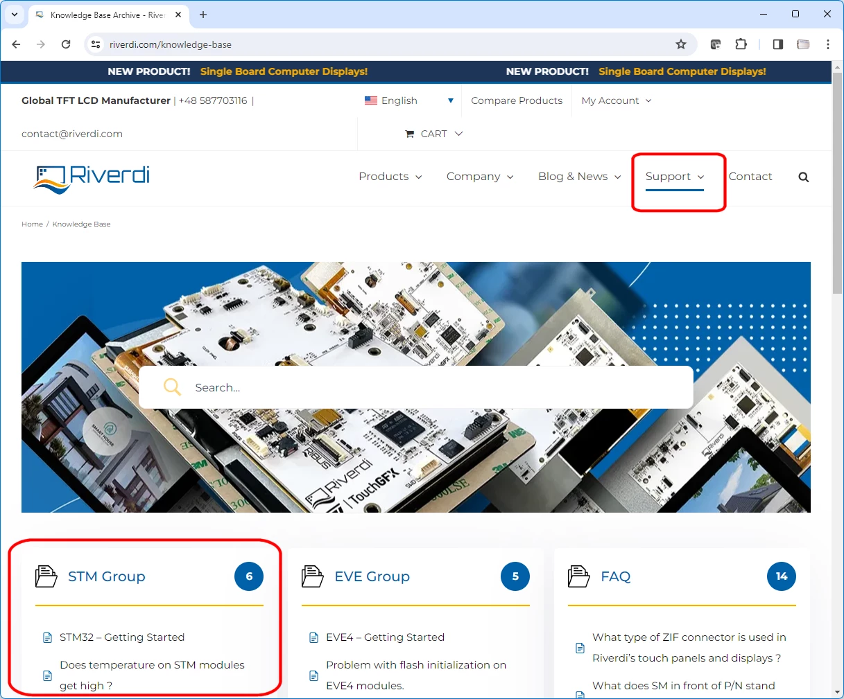

@NicoEFI wrote:
on a riverdi RVT70HSSFWCA0 screen
Have you asked Riverdi that?
They would be the ones to provide examples targetted for their particular boards:
https://riverdi.com/knowledge-base
https://riverdi.com/contact
NicoEFIAuthor
Feb 23, 2024 12:45 PM UTC
Yes I sent them an email request but still no response.
