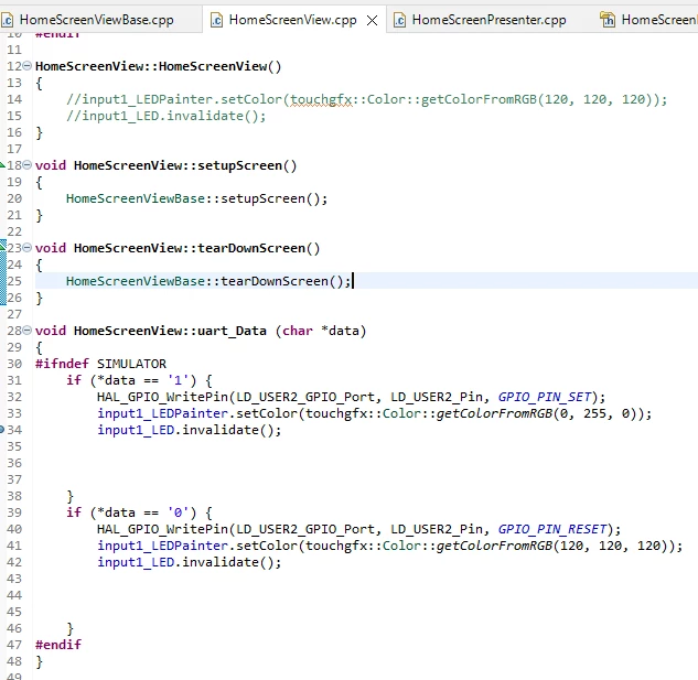

Hello all,
I have made a GUI with some circles that show as a LED. When the LED must be turned on the color of the circle shall be green and LED is OFF then the color must be changed to gray. So when I change the screen to another and back again, the color changes to a default value. As I understand I need to save the status to the Presenter and then to the model afterward I should get the status from the model and then the presenter. So now I want to know how to save the circle's color when leaving the screen.
here is the screen shot for screenview:

GaetanGodart
May 3, 2024 8:26 AM UTC
Hello @ayoub ,
You are right, you need to save the value (or a simple boolean would work in your case) to the model.
To do so, I would create a variable storing the color in the model, then creating two functions: a getColor and a setColor and make them reachable from the screen so you can manipulate your variable.
To learn how to do that, I advise you to read our tutorial 3 which will teach you everything you need to use the model vie presenter architecture : TouchGFX tutorial 03
Furthermore, I advise you to read more about how MVP works : TouchGFX MVP article
If the comment answer your question, I advise you to select it as "best answer".
Regards,
Gaetan GodartSoftware engineer at ST (TouchGFX)

ayoubAuthor
May 3, 2024 8:52 AM UTC
Hello @GaetanGodart
Thank you for your information. I have created it as you mentioned it. I am trying to save the color of the painter with the function getColor().
Now I have a function to save to the color with a colortype in presenter and this is OK and there is no error compilation.
In Model.cpp I need to create the function that I created in presenter and also another function to retrieve the color value.
These two functions need colortype as input argument and return argument. The issue is that I got compilation error that show as below:
 ../../TouchGFX/gui/include/gui/model/Model.hpp:21:30: error: 'colortype' has not been declared
I include the following header files in Model.cpp
#include <touchgfx/Color.hpp>
#include <touchgfx/hal/Types.hpp>
Here is some code from ScreenView, Presenter and model:

ayoubAuthor
May 7, 2024 6:11 AM UTC
Hello @ GaetanGodart
I have added the touchgfx/colortype (Check Model.hpp) .  Now the problem is solved by adding or casting the class in Model.cpp when I am using a colortype variable. (adding touchgfx::colortype in Model.hpp)
Thank you all for your help and input!

void Model::tick() {
#ifndef SIMULATOR
if (osMessageQueueGetCount(uartQueueHandle) > 0) {
if (osMessageQueueGet(uartQueueHandle, &uartData_r, 0, 0) == osOK) {
strncpy(RData, uartData_r->Data, uartData_r->size);
modelListener->uart_Data(RData);
#endif
void Model::saveToggelButton(bool State )
toggleButtonState = State;
bool Model::getToggleButton()
return toggleButtonState;
void Model::save_input1_LED(touchgfx::colortype painter)
colorStatus_LED = painter;
touchgfx::colortype Model::getStatus_input1_LED()
return colorStatus_LED;
//-----------------Model.hpp--------------------
#ifndef MODEL_HPP
#define MODEL_HPP
class ModelListener;
class Model {
public:
Model();
void bind(ModelListener *listener) {
modelListener = listener;
void tick();
void saveToggelButton(bool State );
bool getToggleButton();
void save_input1_LED(touchgfx::colortype painter);
touchgfx::colortype getStatus_input1_LED();
protected:
ModelListener *modelListener;
char RData[257];
int inputLEDS;
bool toggleButtonState;
touchgfx::colortype colorStatus_LED; //casting the class to using colortype
#endif // MODEL_HPP
GaetanGodart
May 8, 2024 8:28 AM UTC
Hey @ayoub ,
I am glad you were able to solve your issue!
Regards,
