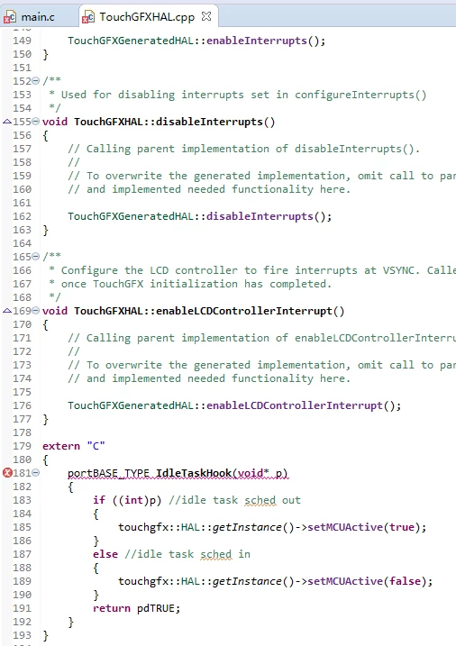

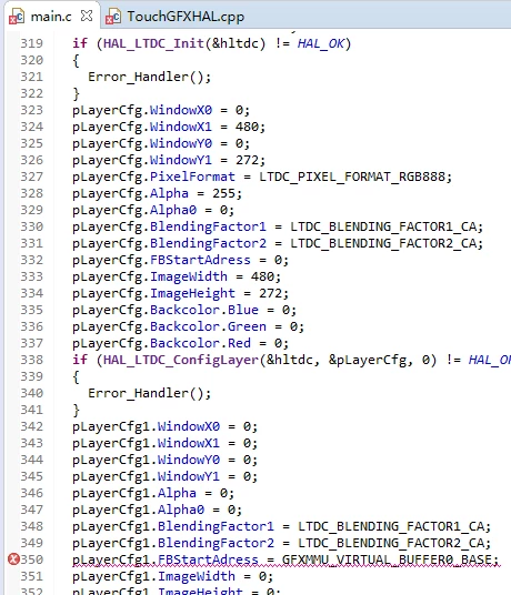

zaric
zaricAuthor
Sep 11, 2020 1:24 AM UTC
thanks for your answer.
And following it,I download an example for touchGFX designer, copy out the .ioc inside the project,
then unselect the freeRTOS and generate another code in cubeMX.
A question came out,as the pictures shown .
Alexandre RENOUX
Visitor II
Sep 11, 2020 6:22 AM UTC
You can delete the IdleTaskHook() function. This is used only when using FreeRTOS to know approximately the load (in percentage) of the MCU in real-time.
Therefore, you can also remove everything regarding MCUInstrumentation in TouchGFXHAL.cpp as well (usually at the beginning of the file).
For the GFXMMU issue, I need more info. What board are you using ? Do you have a round display ? What is written exactly for this error ?
/Alexandre
zaric
zaricAuthor
Sep 14, 2020 7:10 AM UTC
now,seems that the GFXMMU not a issue.
Using stm32H750B-DK
there is a new problem: run the app in borad , I got a white blank screen. then I use the beyong compare to compare code of demo and my app, no differences in initialization\configuration.
