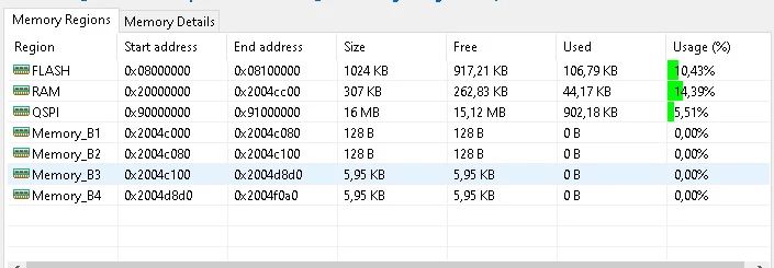

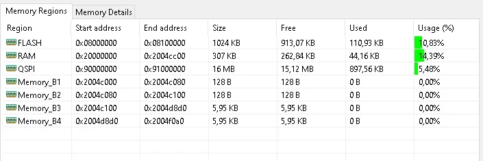

Ciuffoly
CiuffolyAuthor
Senior
January 31, 2022
I see that using this modification the function go in QSPI and the flash used is reduced.
Is this correct ?
static void Page1(void);
// void Page1(void);
main()
Page1();
static void __attribute__((section(".textqspi"), noinline)) Page1(void)
//void Page1()
 In any case I see that it possible pass in the QSPI only some user parts of code because other parts like the graphic lib must run in flash.
