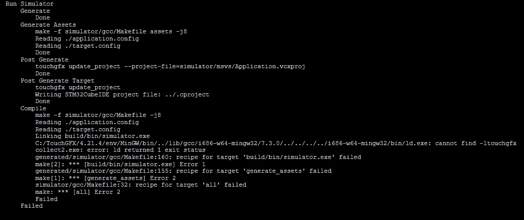

I upload file in directory and get no error but now I can't run simulator:
Graduate II
May 19, 2023 3:52 PM UTC
Is the folder "C:\Users\martynasveit\Desktop\C7_2(20230226)\C7_SVN\Middlewares\ST\touchgfx\lib\win\mingw32" also empty, there should be file "libtouchgfx.a" ?
