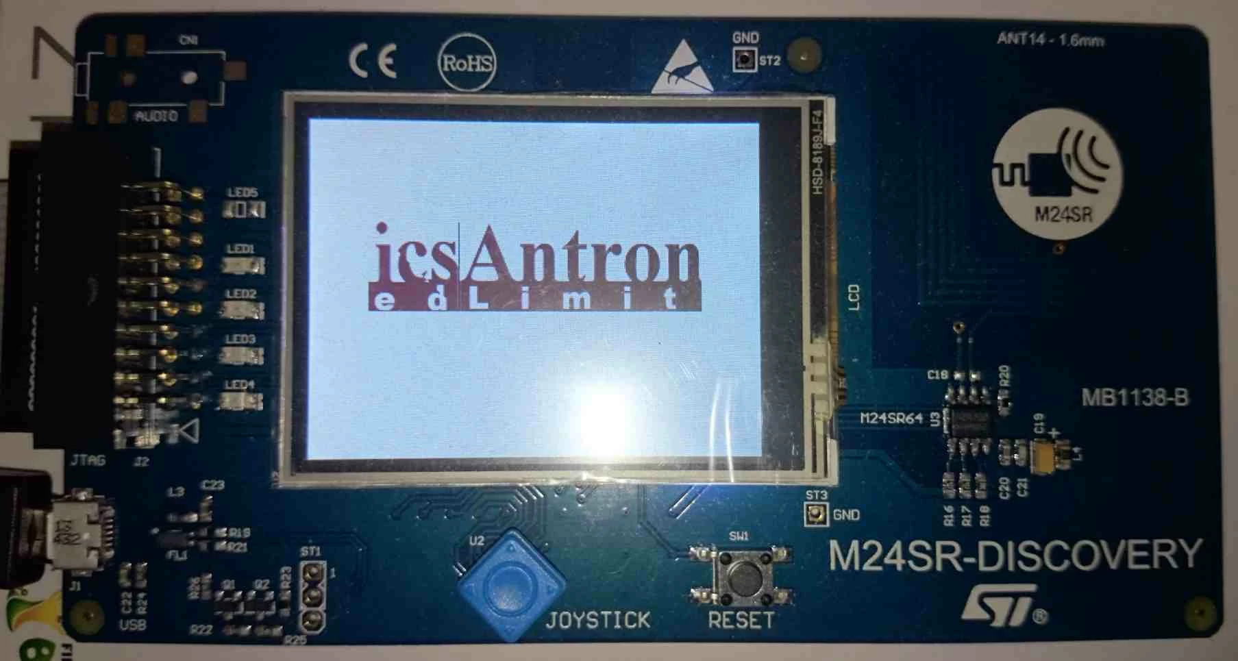

Andrew Neil
Aug 13, 2014 4:00 PM UTC
Posted on August 13, 2014 at 18:00
I found this ''
BMP to C image conversion utility'':
http://www.lpcware.com/content/nxpfile/bmp-c-image-conversion-utility
It creates an array of 16-bit values:
* BMP image data converted from 24bpp
* to RGB565
#define COLOR_BPP 16
#define COLOR_STORAGE_SIZE 2
#define BMPWIDTH 239;
#define BMPHEIGHT 65;
const
unsigned
short
image16[] = {
0xffff, 0xffff, 0xffff, 0xffff, 0xffff, 0xffff, 0xffff, 0xe69a,
0xab6d, 0x9a69, 0xb3ae, 0xeefb, 0xffff, 0xffff, 0xffff, 0xffff,
0xffff, 0xffff, 0xffff, 0xffff, 0xffff, 0xffff, 0xffff, 0xffff,
0xffff, 0xffff, 0xffff, 0xffff, 0xffff, 0xffff, 0xffff, 0xffff,...
I just used a quick regular-expression search & replace to split into bytes:
0xff, 0xff, 0xff, 0xff, 0xff, 0xff, 0xff, 0xff, 0xff, 0xff, 0xff, 0xff, 0xff, 0xff, 0xe6, 0x9a,
0xab, 0x6d, 0x9a, 0x69, 0xb3, 0xae, 0xee, 0xfb, 0xff, 0xff, 0xff, 0xff, 0xff, 0xff, 0xff, 0xff,
0xff, 0xff, 0xff, 0xff, 0xff, 0xff, 0xff, 0xff, 0xff, 0xff, 0xff, 0xff, 0xff, 0xff, 0xff, 0xff,
The Width & Height values seem to need to b reduced by two each to work with the ST stuff. But I end up with the image appearing ''wrapped'' in the display: 0690X00000603HsQAI.jpg

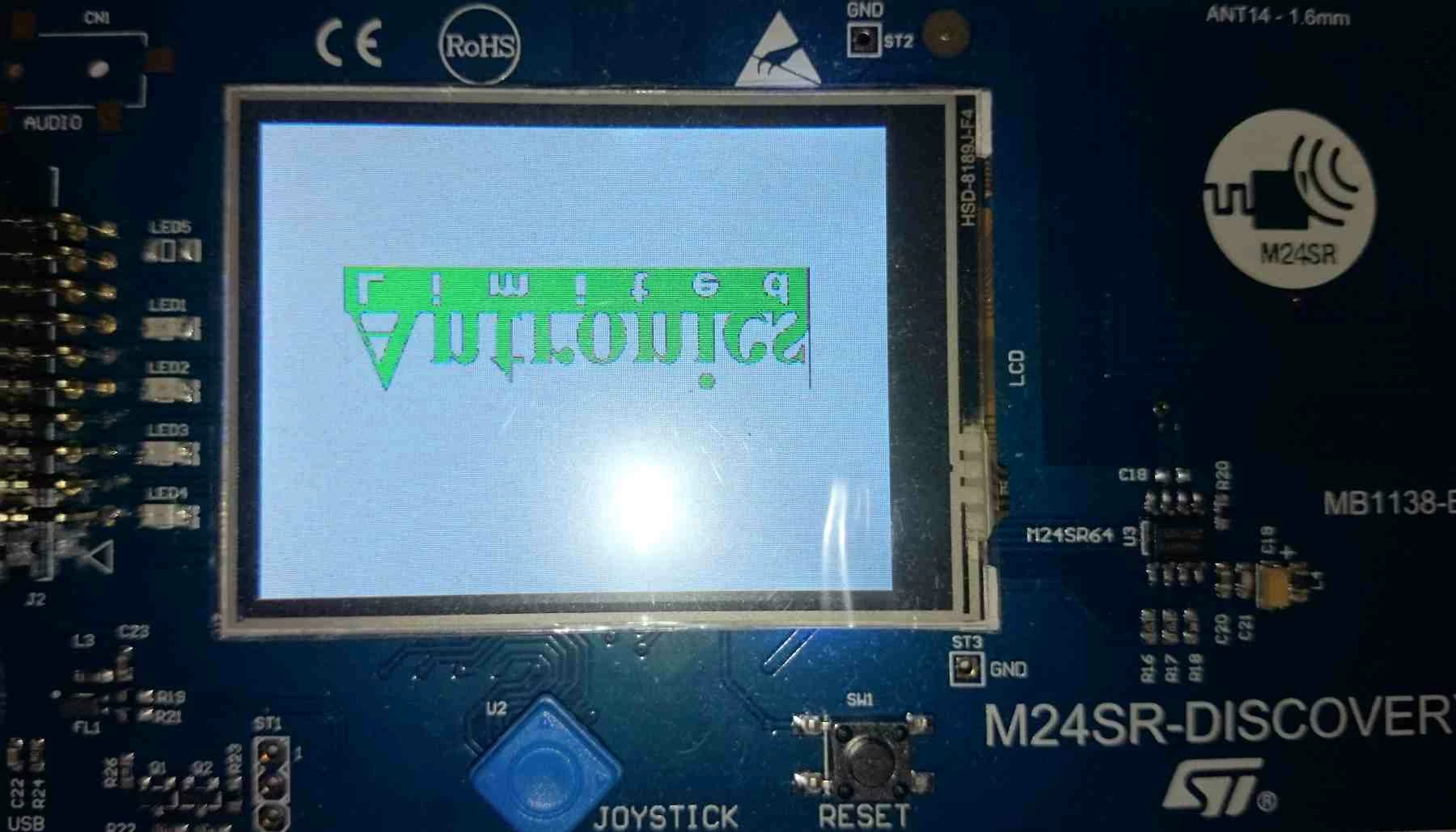

Andrew Neil
Aug 13, 2014 5:59 PM UTC
Posted on August 13, 2014 at 19:59
STSW-STM32098
STM32 embedded GUI library (AN3128)
http://www.st.com/web/catalog/tools/FM147/CL1794/SC961/SS1743/PF257934#
Includes a Resource Editor - which can convert a BMP file to a 'C' array.
But the result is upside down (actually, reflected in the horizontal axis).
eduardo2
eduardo2Author
Aug 13, 2014 6:10 PM UTC
Posted on August 13, 2014 at 20:10
What I found is actually a software tool from STMicorelectronics that worked perfectly:
Resource Editor For Embedded GUI Library version 2.0.0.0
you go to Tools menu, then Image 565 Converter. Load the image and click on convert and the tool will open a Word file with the actual C code that you need. There're a couple of options if you want your code with the header or not. Copy and paste into your code and your are done.
This is part of the STM32 embedded graphic objects/touchscreen library AN3128.
Andrew Neil
Aug 13, 2014 7:21 PM UTC
Posted on August 13, 2014 at 21:21
Yes, that's the one I used - but, as I said, the result is ''upside down'':
But then it's not actually stated that the
M24SR-Discovery is using the same graphics format...

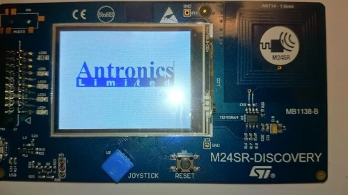

Andrew Neil
Aug 14, 2014 6:16 PM UTC
Posted on August 14, 2014 at 20:16
''the result is 'upside down'''
I can fix that by inverting the bitmap before converting it.
Also had to modify the LCD_WriteBMP_FAT() function to get the bytes in the correct order for the right colour - blue, not green:
