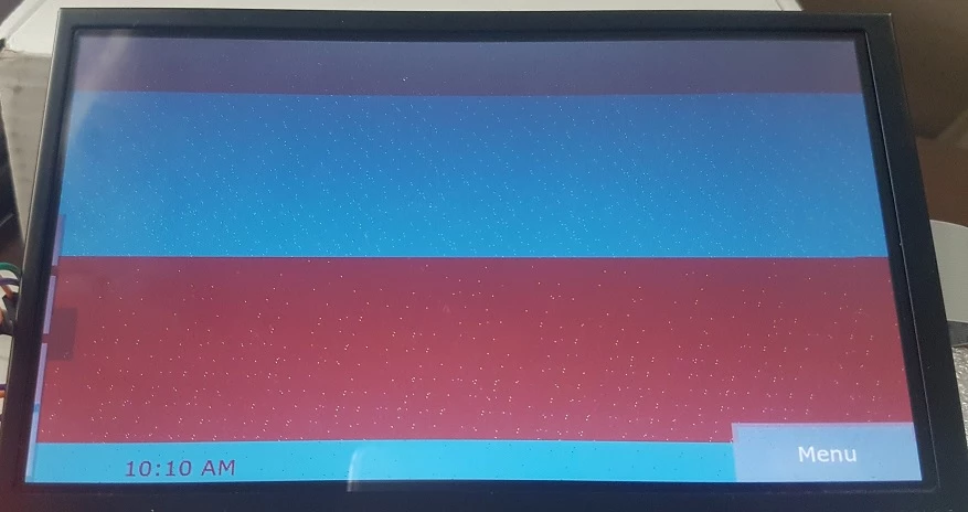

Normally I can display all projects of touchgfx (which can be stored in internal memory) on my touchscreen without any problem.
For a larger project I needed to use a SD card. For this purpose, I compiled all the images into a .bin file and then saved it to SD card. I try to use blockcopy function as shown below but all I get is just a black screen.
To sum up, I dont know how to call the images. it will be appreciated if someone correct the mistakes or shift me to the the correct way.

I couldn't achieve to display the images and I attached the result.
I can navigate through the pages of GUI coz it displays the buttons like a shadow. I couldn't find out the missing point.

Check in debuger breakpoint at line 2 how address is in cacheStartAddr.?

I changed it as;
uint16_t* cacheStartAddr = (uint16_t*)0xD1000000;
MM..1
January 3, 2021
This is next chaos information please explain your full config, how SDRAM, where mapped, STM32xxxx usw ????
Adress 0xD1000000 is FYI 16M in SDRAM then your SDRAM when is mapped on 0xD0000000 must be 32M or more. ?

sorry for the missing information. yes my sdram is 32M and it is mapped to 0xD. I used 0xD0000000 and 0xD00D2F00 as double buffers of touchgfx. This demo version graphics occupies 4.7 MB.
 uint32_t cacheSize = 0x500000;

Then you read Using Non-Memory Mapped Flash for Storing Images | TouchGFX Documentation
and apply last part link in RAM, when your 16M is free and dont plan bigger bin file.
Remove all caching...

the GUI size will be bigger than the ram size so I cannot store them as you suggested.
MM..1
January 4, 2021
Then all you need is  Using Non-Memory Mapped Flash for Storing Images | TouchGFX Documentation
except last part link. But i mean your idea cacheall when your image is over ram size isnt logic.
You need apply one screen graphics must have size under ram size for cache and too empty your cache on change screens.
