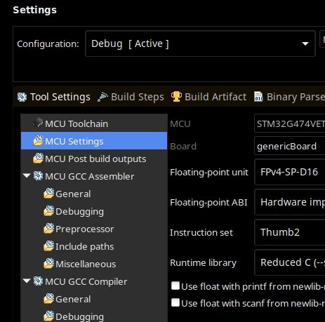

and you have enabled print-float ?
-> use float with printf...
BhavyaSriAuthor
Sep 24, 2024 9:00 AM UTC
Thanks for the response.
I'm not sure where to set this option? can you please provide more details.
AScha.3
Sep 24, 2024 9:12 AM UTC
As all other settings...
in IDE, select your project as "active now" , by having the main.c open or click in left window on the project name;
then menu->project->properties
select ... (as in pic) C/C++ build -> settings -> MCUsettings -> X use float with printf
(then float lib is included in build for this project )
