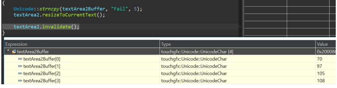

HHarj.1
February 28, 2020
Ok, thank you. I thought I couldn't do even that right, but there is something else then because...0690X00000DXXFWQA5.png I was still not getting it right, so instead of my char array I put test string "Fail" in there, and the display shows ?a?l
