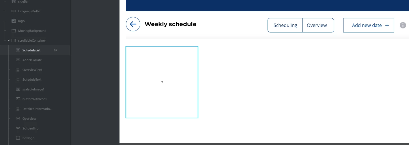

I need pass just a variable from container to view. In custom container I have button and I need to pass how many times button was pressed. Problem is this that I create in view screen list layout and in that list putting custom container
_legacyfs_online_stmicro_images_0693W00000biQYZQA2.pngCustom container:
And in this container u can see plus button which I need to know how many times it was pressed because I need to know that value to create other list element.. I do not know are u understand :D Maybe u have other solution?

Not completely understand, it is difficult when not see the hole picture how you have organize the things in UI.
But you could send trigger callback everytime when plus is pressed, or simply keep the count of presses in the container local variable and then read the counter value from parent class with simple function when adding things is finished ?

It's difficult to explain :D amm, that container is not included in my view window and I can't access it. If I add custom container in my view it would be easy but now I've created list layout and in that list is custom container .
Like this:
I can send more code if it helps to understand what I want :D

Did you find a solution to your problem? If not, I was thinking maybe you can store your value from your container in the model and then get that value in your view screen.
/Osman
