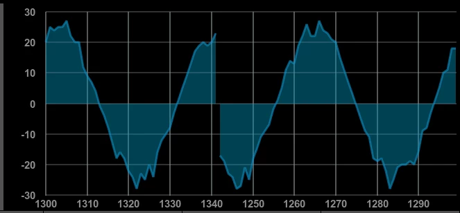

But what Touchgfx gives me is this:
0693W000008ypgaQAA.pngAs we can see from above, X axis label show data point instead of time in seconds and the label grows instead of fixed.

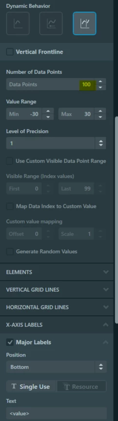

Setting:
0693W000008yphcQAA.pngMy development board is:

Problem 1: keeping the x-axis fixed. See my thread on how to reset the X-axis. Call this every 10 seconds / 100 points / whenever the graph rolls over.
Problem 2: mapping the x-axis values to something that isn't the datapoint index. You're looking for the x-axis scale. Change it to 0.1 - that way for each datapoint you add, the x-axis number it maps to increases by 0.1. Edit: increase the level of precision above 1 so that the graph can properly represent your data.

Two things to try. Select the graph widget in TouchGFX designer and:
  1. Increase the Level of Precision (under Data Points)
  2. Increase the number of Decimal Points (under X-Axis Labels -> Major Labels)
Edit: just tried it, to fix the zeros you only need to increase the level of precision. Then you can add as many or as few decimals as you want to the x-axis labels.
Embedded UI/UX Consulting: cadenza.design
BParh.1
BParh.1Author
Senior III
Apr 9, 2021 12:34 AM UTC
Thank you so much @Michael K​ , it works great :)
