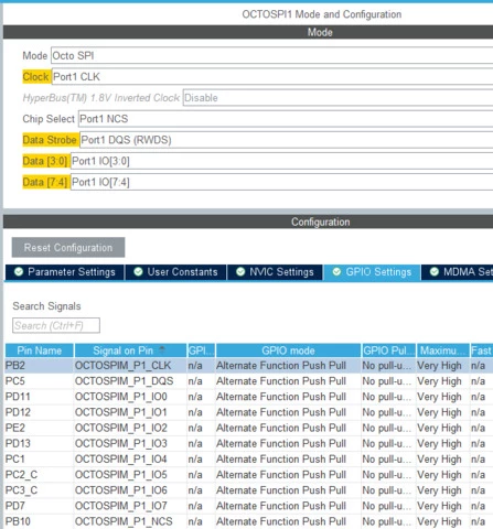

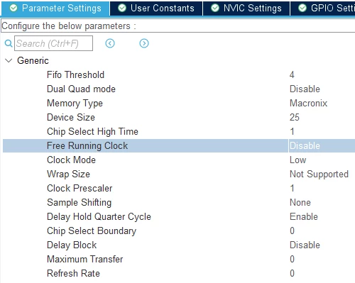

I am using below configuration
0693W00000KcDD9QAN.jpg0693W00000KcDDEQA3.pngThere is source for QSPI but dont have OctoSPI.

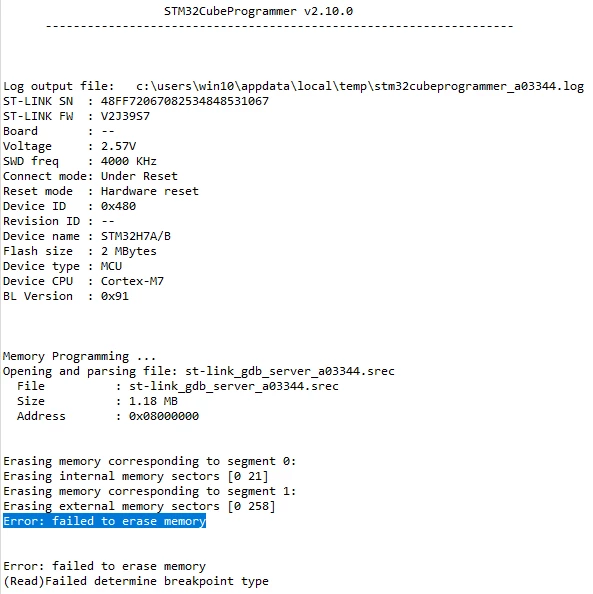

I created external loader for custom board. But it didnt work. I am getting below errror.
0693W00000KcCqzQAF.pngI shared external loader project file at attachment. Can you review it please? I need your support.

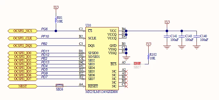

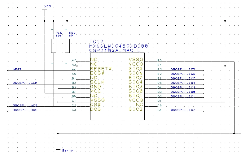

PDixo.1
May 6, 2022 9:23 AM UTC
My connections are the same as the STM32H735G-DK board.
J13 PD11 OSCSP11_100
J15 PD12 OSCSP11_101
C3 PE2 OSCSP11_102
H15 PD13 OSCSP11_103
C9 PD4 OSCSP11_104
B9 PD5 OSCSP11_105
A8 PG9 OSCSP11_106
B8 PD7 OSCSP11_107
K3 PF10 OSCSP11_CLK
P7 PB2 OSCSP11_DOS
F14 PG6 OSCSP11_NCS
Extract from STM32H735G-DK schematic and my schematic.
