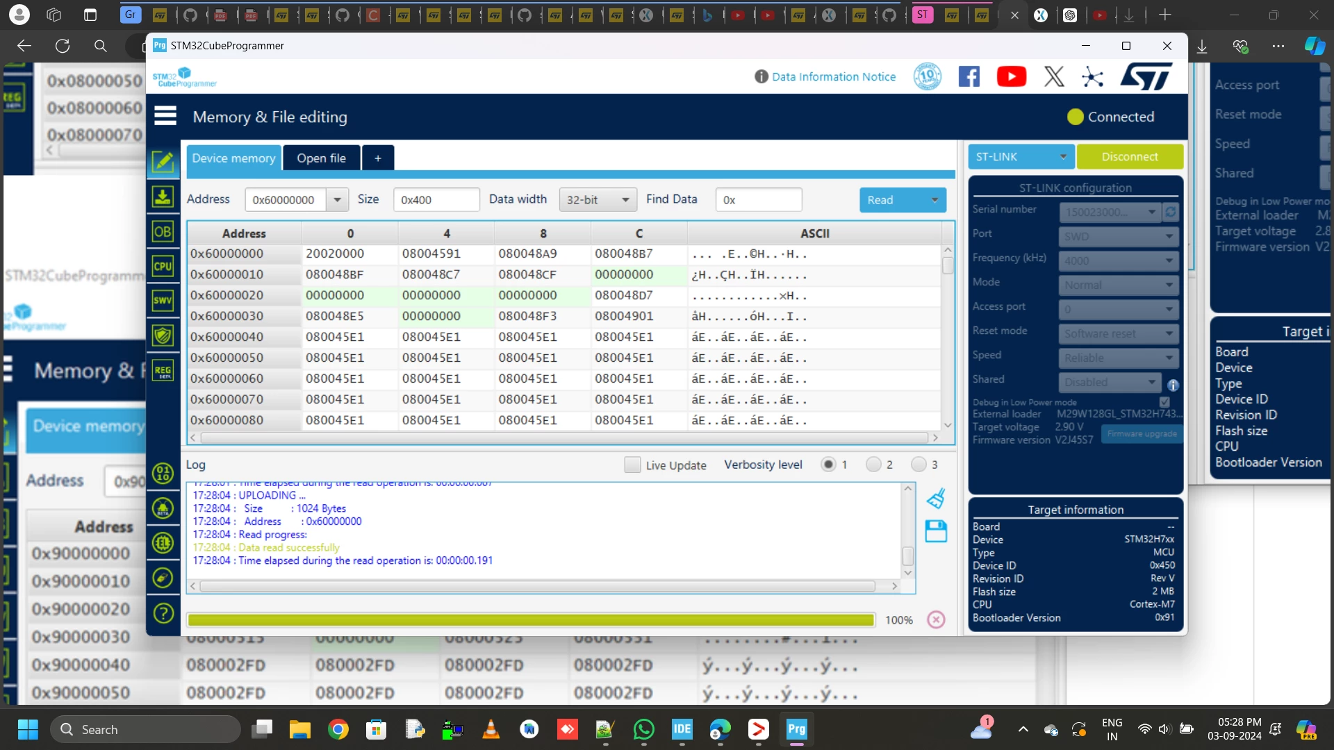

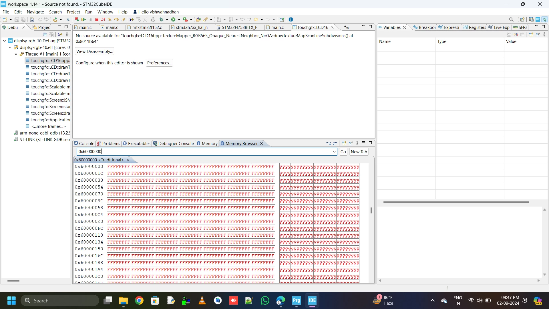

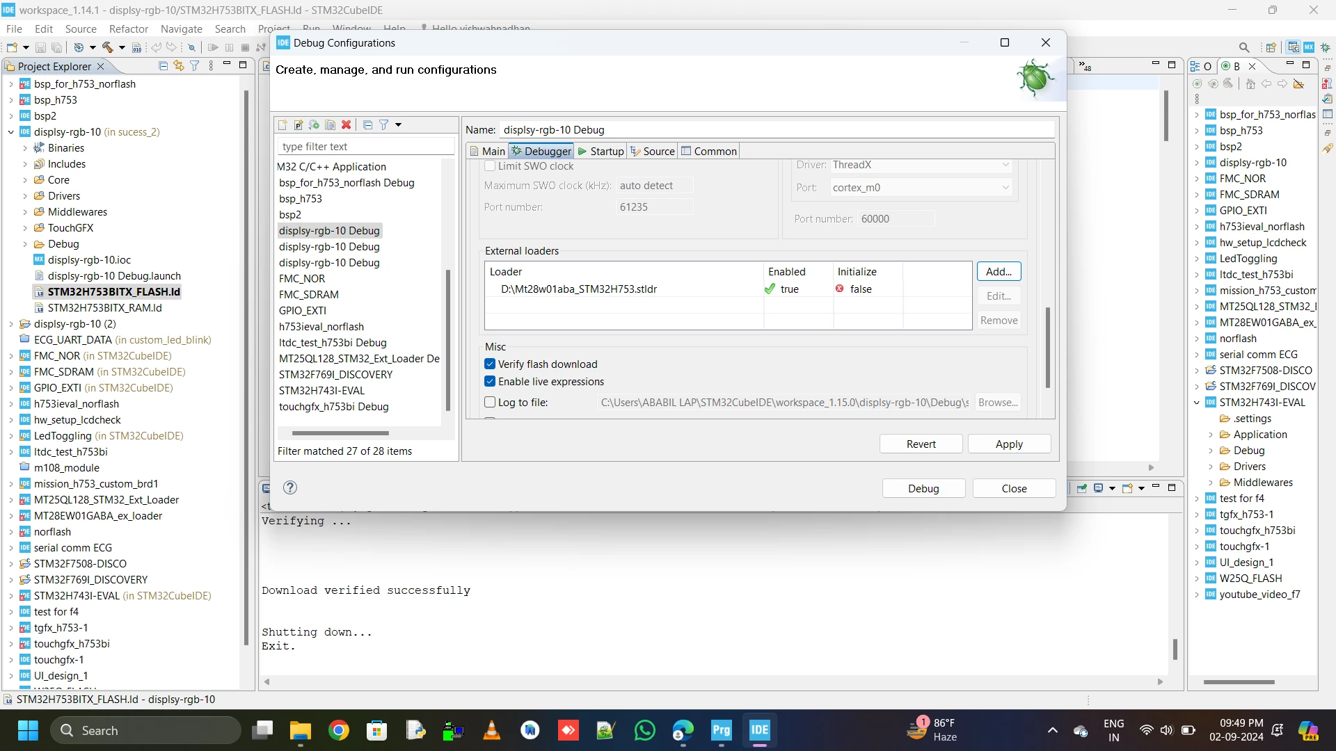

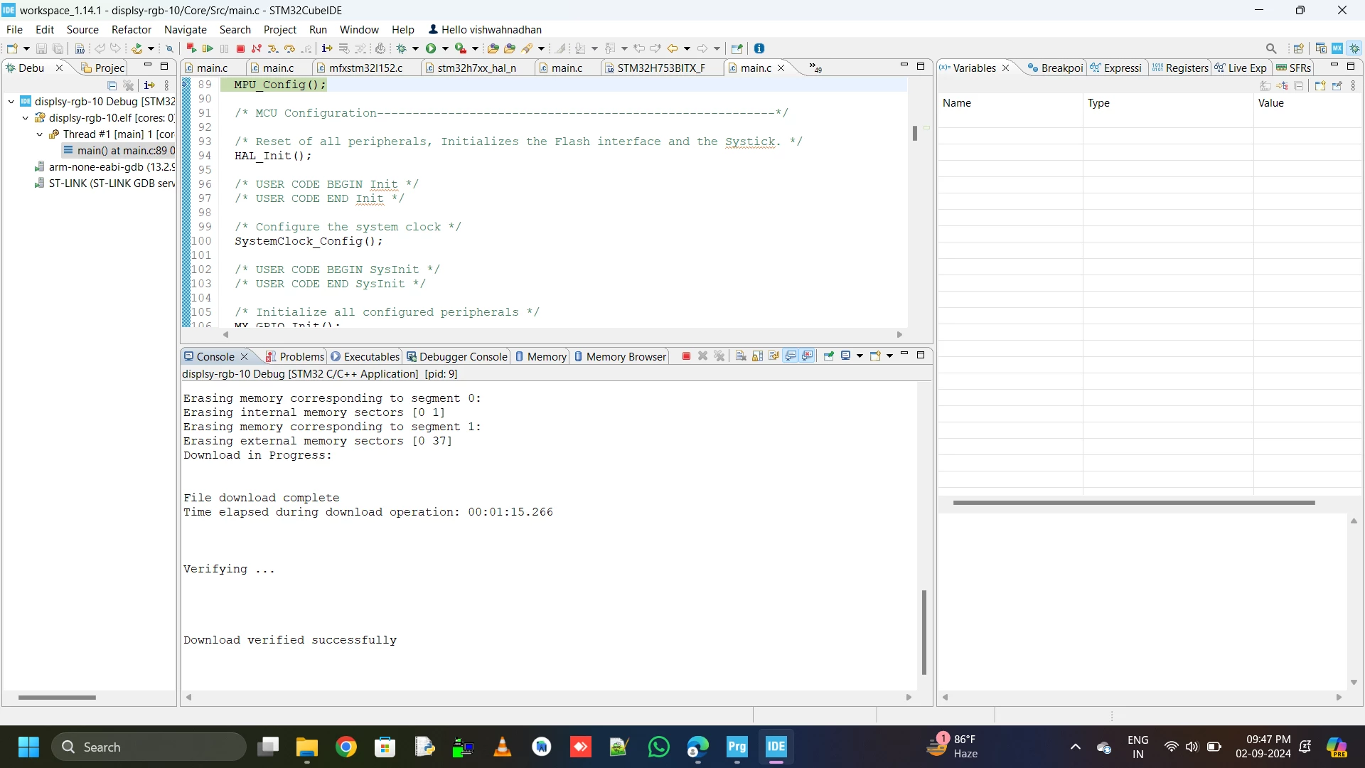

Hi Team,
After assigning NOR Flash space in the linker, I created an external loader, tested it, and debugged it in CubeProgrammer. @mƎALLEm  suggested to seek help regarding my TouchGFX-related query in a new thread.
Is there any reference or guide available for implementing FMC NOR Flash in a TouchGFX project within CubeIDE? I added my own loader in the debug configuration and debugged it, but no data is shown on the display, nor is anything visible at 0x60000000 in the memory browser.
Please guide me on how to achieve full access via Flash memory.

jr_engr_mbedBest answer
Senior
Oct 21, 2024 6:57 AM UTC
Hi @GaetanGodart @Tesla DeLorean @mƎALLEm  , Here's an update regarding FMC NOR flash: I was successfully able to run NOR flash after changing the NOR flash IC from 1 Gbit to 128 Mbit. I replaced it with the same 56-TSOP package. Now, I can load TouchGFX data into my NOR flash. Thank you for guiding me for such a long time. i found data mismatch error in 01 gbit norflash, where full data is not loaded properly, after changing 128mbits  flash, i can get full data exactly.

Tesla DeLorean
Guru
Sep 2, 2024 4:35 PM UTC
Bring up the NOR Flash as you did with the External Loader  Init(), so clocks, pins, peripheral, ..
You should ideally do this in SystemInit(), but the Cube approach might make that more practical at the beginning of main()
You should be able to confirm / dump the expected content after you've brought the memory up.
Senior
Sep 3, 2024 6:44 PM UTC
Hi Tesla,
  1. As you suggested, I implemented the test code directly in the main() function of the TouchGFX project. I've already allocated space, and the TouchGFX-generated images are stored in the .ext_flash section. How can I redirect this data to the txbuffer at address 0x60000000? Is the external loader sufficient for displaying the images, or do I need to write a driver for non-memory mapped mode? Is the driver you're referring to the same as the external loader?
