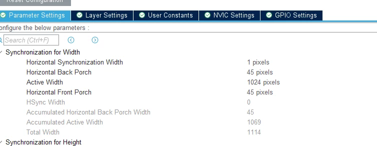

I'm using an STM32H7S78-DK with TouchGFX and FreeRTOS. I would like to limit the framerate of the target to 30fps but withouth reducing the LTDC frequency.
Basically having the VSYNC fired at 30fps
I've already set the
 ((touchgfx::HALSDL2*)&hal)->setVsyncInterval(33.333);
In the simulator
Is there a way to force it on the target?
unsigned_char_array
Lead III
May 11, 2026 8:23 AM UTC

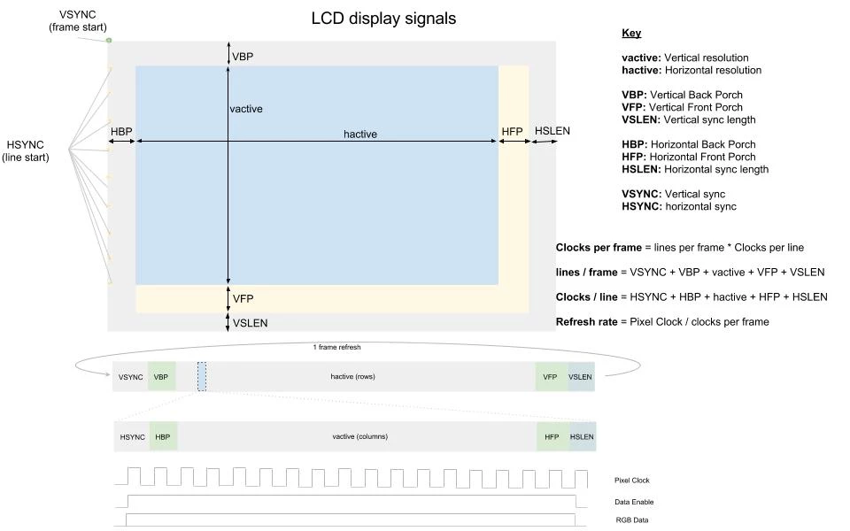

You can increase the front and back porches in your LTDC.
This way you use more LTDC clock cycles per frame so your frame rate drops.

nico23Author
Senior III
May 11, 2026 8:15 AM UTC
what? Would you be more precise
unsigned_char_array
Lead III
"Kudo posts if you have the same problem and kudo replies if the solution works.Click ""Accept as Solution"" if a reply solved your problem. If no solution was posted please answer with your own."
nico23Author
Senior III
May 11, 2026 10:59 AM UTC
Hi @unsigned_char_array
Thanks a lot for the answer. My goal in reducing the refresh rate was to save CPU cycles for other operations; with the approach you propose, it feels like I'm just burning CPU cycles to drop the FPS, without really removing work to process the frame, or am I wrong?
Studying a bit, I've found out that another way is to use a custom timer set to 30Hz and toggle the VSYNC pin, but I think that's way more tricky than changing parameters in CubeMX
unsigned_char_array
Lead III
May 12, 2026 8:14 AM UTC
 The CPU is not busy waiting (blocking) for LTDC interrupts. You'll actually get more idle time per frame.
