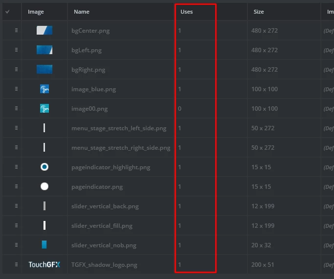

A lot of images are uploaded in to my TouchGFX project. I would like to removed unused images from there. How would I know if a particular image is used in the project or not? For example, Texts -> Typographies tab shows how many uses a particular font has. Similarly, is there a way to know if a particular image is used or not?

MM..1
March 1, 2022
Simply check and search in code every image ID from database. Designer dont count about...

I thought about this approach. But this is a long and time consuming approach considering number of images in the project. I am trying to see if there is an easier way like the text fonts I mentioned above.

in header file for example
const uint16_t BITMAP_BL1_ID = 0;
const uint16_t BITMAP_BL2_ID = 1;
const uint16_t BITMAP_BLB_ID = 2;
const uint16_t BITMAP_BLW_ID = 3;
comment all out and build
you see errors on used IDs

Hello BGuth.1,
Are you using the latest version of TouchGFX Designer (4.18.1) ?
Because the number of uses is clearly shown for images as well

I am using v4.16.1. I tried to migrate to 4.18.1 but encountered problems. Please see https://community.st.com/s/question/0D53W00001KRP0USAX/error-with-touchgfx-conversion-from-4170-to-4181.
I was requested to send the project to you guys. But I am not able to do that. May be you can suggest a solutions based on the information posted in there so far. Please let me know.
Good to know the feature exists in v4.18.1.
