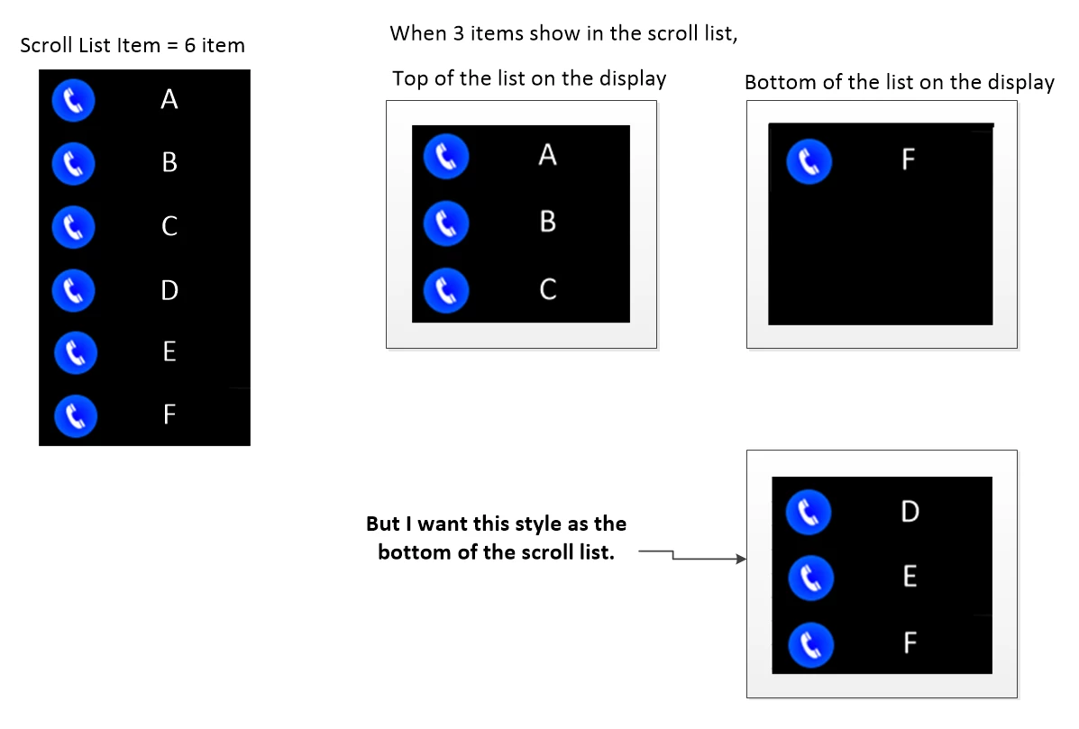

After I made 6 items for a scroll list, I made them to show 3 items on a sreen.
When I dragged to the top, the 1st, 2nd and 3rd item showed as I expected. And when I dragged to the bottom, I expected the last 3 items ( 4th, 5th and 6th) show on a screen. But just the last item (the 6th) showed in the screen.
I want to show the last 3 items in that situation.
Is there any option or function to implement it? Or let me know if any other widget to make it.
Sorry for my lack of explanation for it. I hope the attached image can be explained more easily.
Thanks in advance!!

PBull
Mar 24, 2020 11:25 AM UTC
something like this should work:
scrollList.setNumberOfItems(6);
scrollList.setWindowSize(3);
Greetings,

JPark.14
JPark.14Author
Mar 24, 2020 1:17 PM UTC
Thanks for the quick and very correct answer. Perfectly works!
