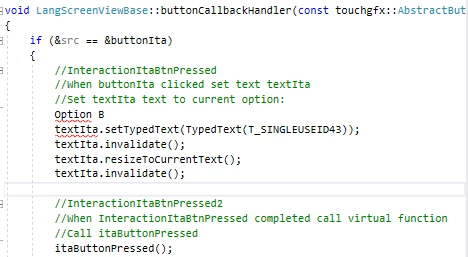

i have this problem, in my app i have a text area which say:
current option:
Option A
using touchGFX i set an interaction when a button is pressed to chage that text area, and i need it to become:
current option:
Option B
when i put those tho line in the text field in the Interaction options on touchGFX like showed
what TouchGFX generates on ScreenViewBase.cpp is this:
and OFC won't compile.
i tryed some escape sequence, but no luck so far...
can someone enlight me.
Thanks in advance
Stefano

Have you considered texts with wildcards? Using wildcard unicode buffers you can replace the text of a textarea runtime.
Step 3 of this tutorial explains how to do that using the designer:
https://touchgfx.zendesk.com/hc/en-us/articles/205587571-Step-3-Adding-Text

What escape sequences did you try? If not \n or \r\n then try them too.

tryed \n, \n\r ,\\n, \0x0A, and whith / instead of \

So what exactly happens with \n for example? I'd think that the generated comment breaking with syntax error should be fixed.

well, with \n there are no errors, but che textArea shown is
current option:\n option B
instead of
current option:
option B

i fix temporaly with a work-around by creating a resource with the phrases i need, in this case works fine because i need few different fixed phrases, but problem persists if i need to change text with something user type, or still something not hard coded

That tutorial article is nice and all, but it doesn't show how to add newlines to a text area from code.
Does snprintf support printing newlines to a wild card buffer? I think not (I've tried)
