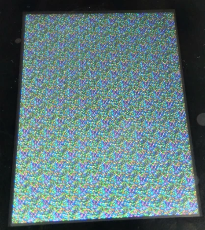

FDe P.1945
December 4, 2019
Nothing shows, only a noise like image. Should we setup something additional?0690X00000AtHT0QAN.png
