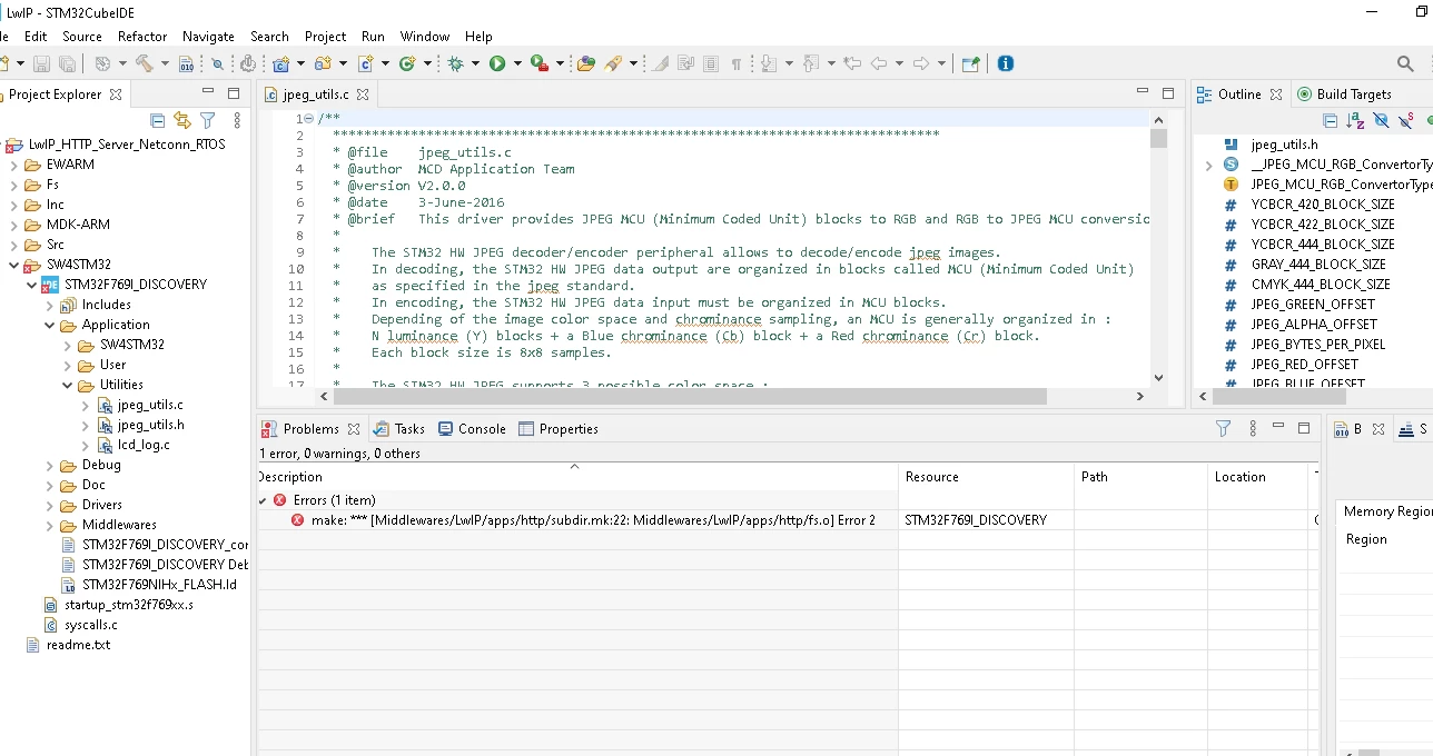

Good afternoon. I made a working project on CubeIDE for a railway timetable (LWIP, FreeRTOS, DSI, HDMI). The project was created in the repository. But the management has a requirement to add a symbolic part (JPG or bmp image). There was a problem when docking the JPEG part to the project (Error 2). How do I remove the problem? With respect. Alexander

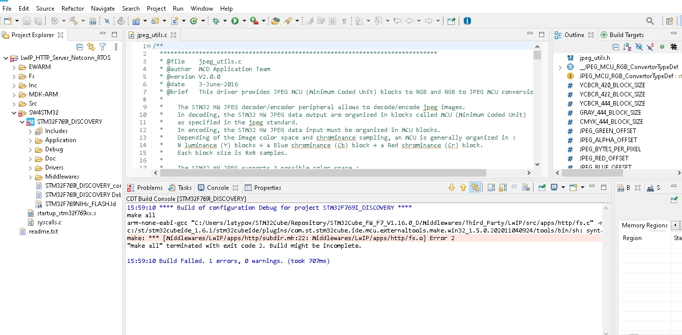

Good afternoon, Houda I found a problem in LWIP. Cubeide searches for lwip/apps/fs.h". There is no such file in the apps directory. But when compiling, CubeIDE finds it. But if the project is in the repository. If the project is rendered as an example of this file, CubeIDE does not find it. He's not there. :grinning_face: With respect, Alexander. пн, 31 ма�? 2021 г. в 13:53, ST Community :

Good afternoon, Houda. No, unfortunately, this project only exists in the repository. I haven't been able to put it together separately yet. When I try to build this project separately, I have problems. I'm using CubeIDE version 1.6, 1. I only initialize the necessary interfaces. The working version of the project in the attachment. This is an example of Lwip_HTTP_Server_Netconn_RTOS from STM32F769 Discovery. I'm working with external DSI-HDMI board. Sincerely, Alexander.

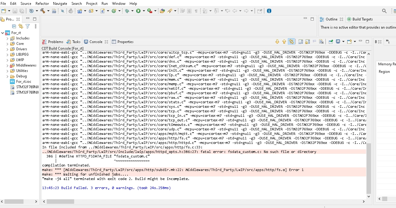

Good afternoon. I created an empty project in CubeMX. LWIP, FreeRtos. After that, I added http. I send you the result with the project.0693W00000BZzLdQAL.png

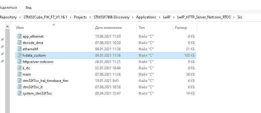

0693W00000BaFczQAF.pngIt's telling you that it can't find any file called 'fsdata_custom.c'
So the obvious first question is: do you actually have an 'fsdata_custom.c' file anywhere in your project?

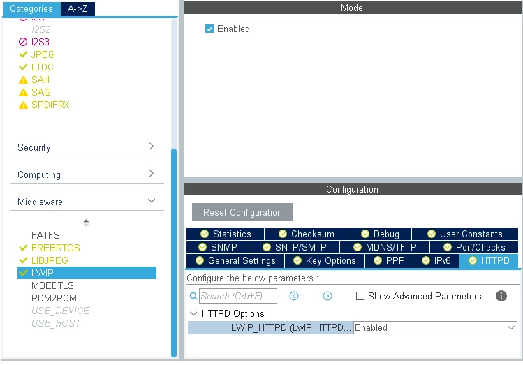

Good afternoon. I ran CubeMX version 6.0.1. I activated JPEG, FREERTOS, LIBJPEG,LWIP.
I started the code generation. Then I ran the compiler from CubeIDE. After that, there are no errors in the project.
Next, I activated the LWIP HTTP option in CubeMX. Then I started generating the code. Then I ran the
compiler again from CubeIDE. After that, I got error 2. Sincerely, Alexander.0693W00000BaERHQA3.png
Vlaty.1
Vlaty.1Author
June 7, 2021
The 'fsdata_custom. c' file is present in the project.0693W00000BaFnsQAF.png
