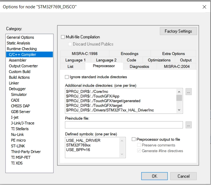

I created a very simple GUI in TouchGFX and generated the code. I then opened the .ioc file in ST32CubeMX and generated the code for each different IDE. The code works in STM32CubeIDE but fails for both EWARM and uVision. Obviously generating the code for each IDE before trying each IDE.
In both EWARM and uVision, I managed to add all the include directories so that the projects could at least find all the .hpp files to try and build.

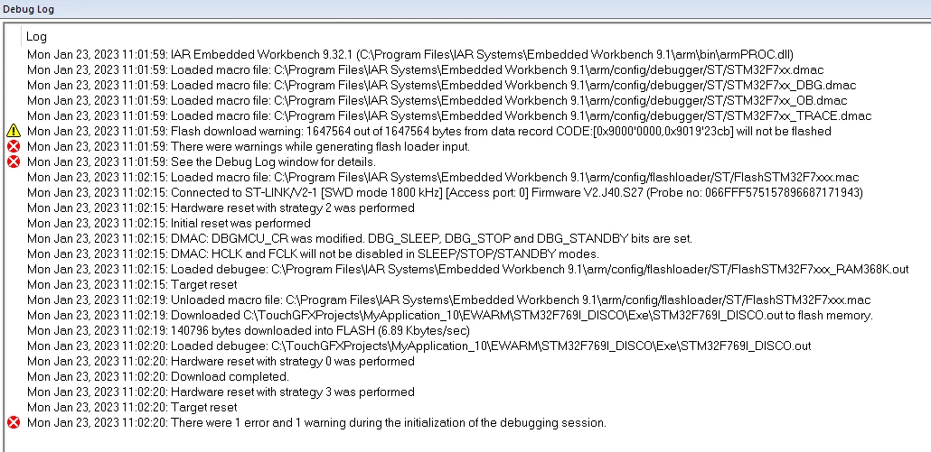

Fri Jan 20, 2023 22:23:10: Flash download warning: 1647564 out of 1647564 bytes from data record CODE:[0x9000'0000,0x9019'23cb] will not be flashed
Fri Jan 20, 2023 22:23:10: There were warnings while generating flash loader input.
Fri Jan 20, 2023 22:23:10: See the Debug Log window for details.
As far as I can tell, IAR can't flash the QSPI Flash on the STM32F769I-DISCO. I have experimented with the default board file but to no avail.

Concerning the log output you're referring (Error[Li005]: no definition for "BitmapDatabase::getInstanceSize()" [referenced from ...) I guess what's missing is the path in the preprocessor configuration. But that shouldn't happen if you create your project the way I described.

0693W00000Y8uQlQAJ.pngLooking at the debug log I get
0693W00000Y8uRPQAZ.pngJust in case you can't read the text, I get this:
Mon Jan 23, 2023 11:01:59: Flash download warning: 1647564 out of 1647564 bytes from data record CODE:[0x9000'0000,0x9019'23cb] will not be flashed

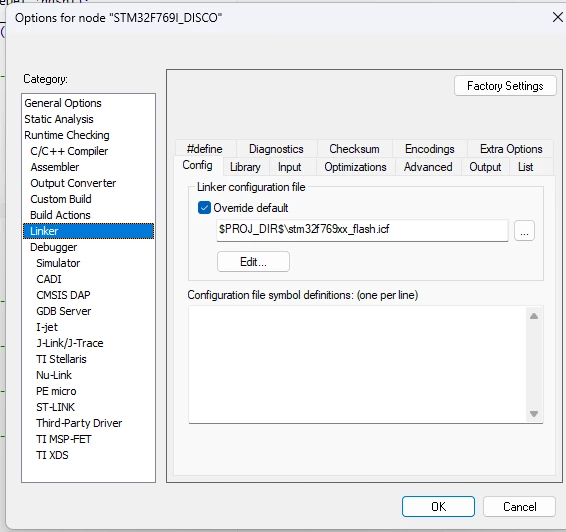

The settings for the linker is as follows
0693W00000Y8uS8QAJ.pngand I'll attached the file and stuck a .c on it in order to upload it.
