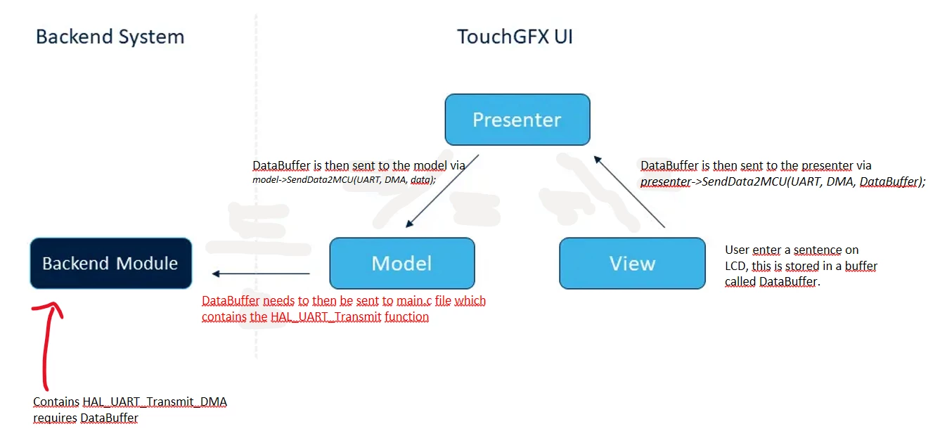

I am using the STM32H745XIH6 board with touchgfx. And I am calling the HAL_UART_Transmit_DMA function in model.cpp whenever the user entered a string on the LCD.
But I would like this HAL_UART function to be execute to main.c instead. How do I do this codewise? I am not very experienced with interacting C++ with C. The function that I want to transfer to main.c is SendData2MCU(int UART, int DMA, uint8_t* data)

Krautermann
Senior
June 28, 2023
I have added a picture which represents how touchgfx LCD works with the backend module (main.c). The text in red is what's missing for me. I do not know how to send the function SendData2MCU from model.cpp to main.c file.
What should I write? main->SendData2MCU ?? This does not work...
MM..1
MM..1Best answer
June 28, 2023
Seems you are complete lost in noOS vs RTOS implement and too with DMA offload and callbacks.
In model or any other part of touchGFX thread you cant wait for complete any operations . Nonsense is wait 100ms or while ()
Exceptions is very quick operations for example less as 1ms SPI usw.
Next nonsense is on every tick call
modelListener->RX1_3Data((char*) RX1_String_cpy, (char*) RX3_String_cpy);
This require check if new value exist ...
Primary your DMA_complete need volatile and right usage is protect next send not wait actual
volatile uint8_t DMA_complete = 1;
while(DMA_complete == 0){};
HAL_UART_Transmit_DMA(&huart1, (uint8_t*) data, strlen((char*)data));
DMA_complete = 0;
and for your question remove senddata2 functions from model and presenter too. Create one in main.c and include prototype in view.cpp, call it directly .
