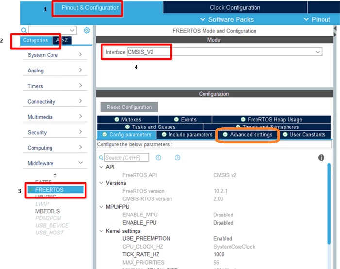

Are there some Advanced Settings for FreeRTOS you can set?
A command line define, or a config file of some sort?

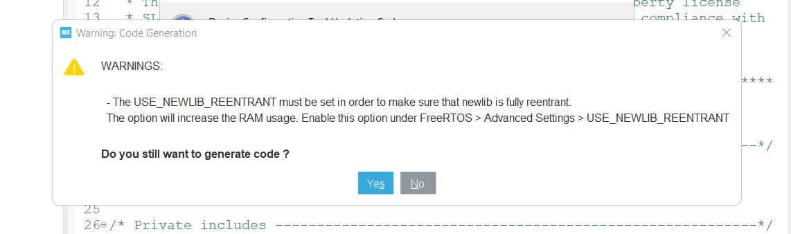

I've this two:
freertos.c and freertos.h
Inside these two libraries is also the NEWLIB function. I can send you the two files and see what needs to be changed
luke514Author
Sep 15, 2022 7:03 PM UTC
I am new to this topic, in front of me I have the STM32CubeIDE 1.10 with the project open. If you can guide me I can send you screenshots of what I see.
Should I look for some library? Change any IDE settings?
Thanks

Apt to be in the
Pinout & Configuration
Addition Software
Middleware
FreeRTOS
