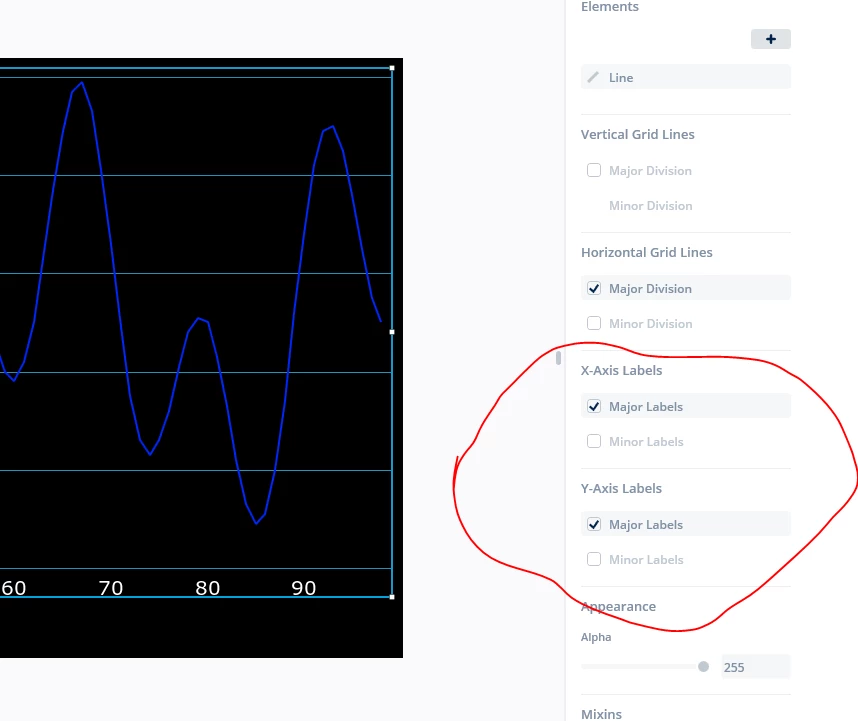

How to edit Dynamic Graph in TouchGFX to print time in X-Axis ?
Hello everyone, I hope you are all having a great day. I would like to know how to work with the labels for the dynamic graph widget :
I want to know how to make the X axis labels display a real time value instead of numbers and I want it to be accurate to the real time, for example : Instead of 10,20  etc I want it to show 01:10 AM, 01:20 AM. etc. can someone help me with this please? Thank You Best Regards.
JTP1Best answer

Hi
I think you cannot get time to the X labels directly from TGFX Designer:slightly_frowning_face:
You need to litte bit manipulate the GraphLabels.cpp (and maybe be GraphLabels.hpp, depends on what you want).
Browse first to \Middlewares\ST\touchgfx\framework\source\touchgfx\widgets\graph\ folder and copy GraphLabels.cpp to your project \TouchGFX\gui\src\common\ folder for example.Edit that copy in \common\ folder.
Here is simple example which prints hh:mm AM/PM format time when number of decimals is set to value 4 in TGFX designer for X Labels.
GraphLabels.cpp:
void GraphLabelsBase::formatLabel(Unicode::UnicodeChar* buffer, int16_t bufferSize, int label, int decimals, Unicode::UnicodeChar decimalPoint, int scale) const
 int length = 0;
 int scaledLabel;
 if (label < 0 && length < bufferSize - 1)
 buffer[length++] = '-';
 label = -label;
 if (decimals == 0)
 	scaledLabel=(label + scale / 2) / scale;
 	Unicode::snprintf(buffer + length, bufferSize - length, "%d", (label + scale / 2) / scale);
	/* HERE Simply Extension to print X label time */
 else if (decimals == 4) // custom print time hh:mm AM when set 4 decimal in the TGFX designer
 	scaledLabel=label;
		// cut down the overflow (24 hours * 60 minutes)
		scaledLabel%=(24*60);
		if(scaledLabel<(12*60))
			Unicode::snprintf(buffer + length, bufferSize - length, "%02d:%02d AM", scaledLabel/60,scaledLabel%60);
		else
			Unicode::snprintf(buffer + length, bufferSize - length, "%02d:%02d PM", scaledLabel/60,scaledLabel%60);
 else if (decimals > 0)
 Unicode::snprintf(buffer + length, bufferSize - length, "%d", label / scale);
 length = Unicode::strlen(buffer);
 if (length < bufferSize - 1)
 buffer[length++] = decimalPoint;
 int remainder = label % scale;
 for (int i = 0; i < decimals && length < bufferSize - 1; i++)
 remainder *= 10;
 if (i == decimals - 1 || length == bufferSize - 1)
 remainder += scale / 2; // Rounding on the last (visible) digit
 const int digit = (remainder / scale);
 buffer[length++] = (Unicode::UnicodeChar)('0' + digit);
 remainder %= scale;
 buffer[length] = (Unicode::UnicodeChar)0;
Note that if you do like this, one point must represent value of one minute in your data to get time domain correct !
Then, your data will naturally start from time 00:00
Which is not allways the case. One way might be to add offset for starting time. So browse to \Middlewares\ST\touchgfx\framework\include\touchgfx\widgets\graph\- folder and open GraphLabels.hpp.
Add variable labelOffset and funtion 'setXStartOffset' to the X labels class.
GraphLabels.hpp:
class GraphLabelsX : public GraphLabelsBase
public:
	/** EXTENSION:
	 * Variable for X -label offset , when using extended time- type X labels
	int labelOffset=0;
	/** EXTENSION:
	 * Function for set X -label offset
	 * offset The X label offset of first the label value
 virtual void setXStartOffset(int offset)
 	labelOffset=offset;
 virtual void invalidateGraphPointAt(int16_t index);
 Then open GraphLabels.cpp and locate GraphLabelsX::drawString- funtion. Add summing of labelOffset to the call of formatLabel. (Note that same format routine is called for X and Y labels, so this offset must be take into account here in the call).
GraphLabels.cpp:
void GraphLabelsX::drawString(const Rect& invalidatedArea, const Font* fontToDraw, const AbstractDataGraph* graph, const int valueScaled, const int labelScaled, const uint8_t a) const
 const int16_t labelX = valueToScreenXQ5(graph, valueScaled).round() - graph->getGraphAreaPaddingLeft();
 if (labelX < 0 || labelX >= graph->getGraphAreaWidth())
 return;
 Unicode::UnicodeChar wildcard[20];
	/*** Extension HERE - labelOffset summed with label- value: */
 formatLabel(wildcard, 20, labelOffset+getIndexToXAxis(graph, valueScaled, labelScaled), labelDecimals, labelDecimalPoint, graph->getScaleX());
 // Adjust to make label centered
 int16_t labelWidth;
 const Unicode::UnicodeChar* text = labelTypedText.getText();
 Then you can set in your view.cpp something like
dynamicGraph1MajorXAxisLabel.setXStartOffset((11*60)+45); //11:45 AM
And then time starts from 11:45 AM
Here are the most important settings of graph in this example:
Number of decimals is set to 4 to activate extended time formatting for X labels. Since the Y label uses the same formatLabel function, there is must something that activates Time format for x labels but not for y (in most cases not needed to have time also in Y label).
This is just simple example how to extend DynamicGraph.
Hope this helps somebody.
Br JTP
