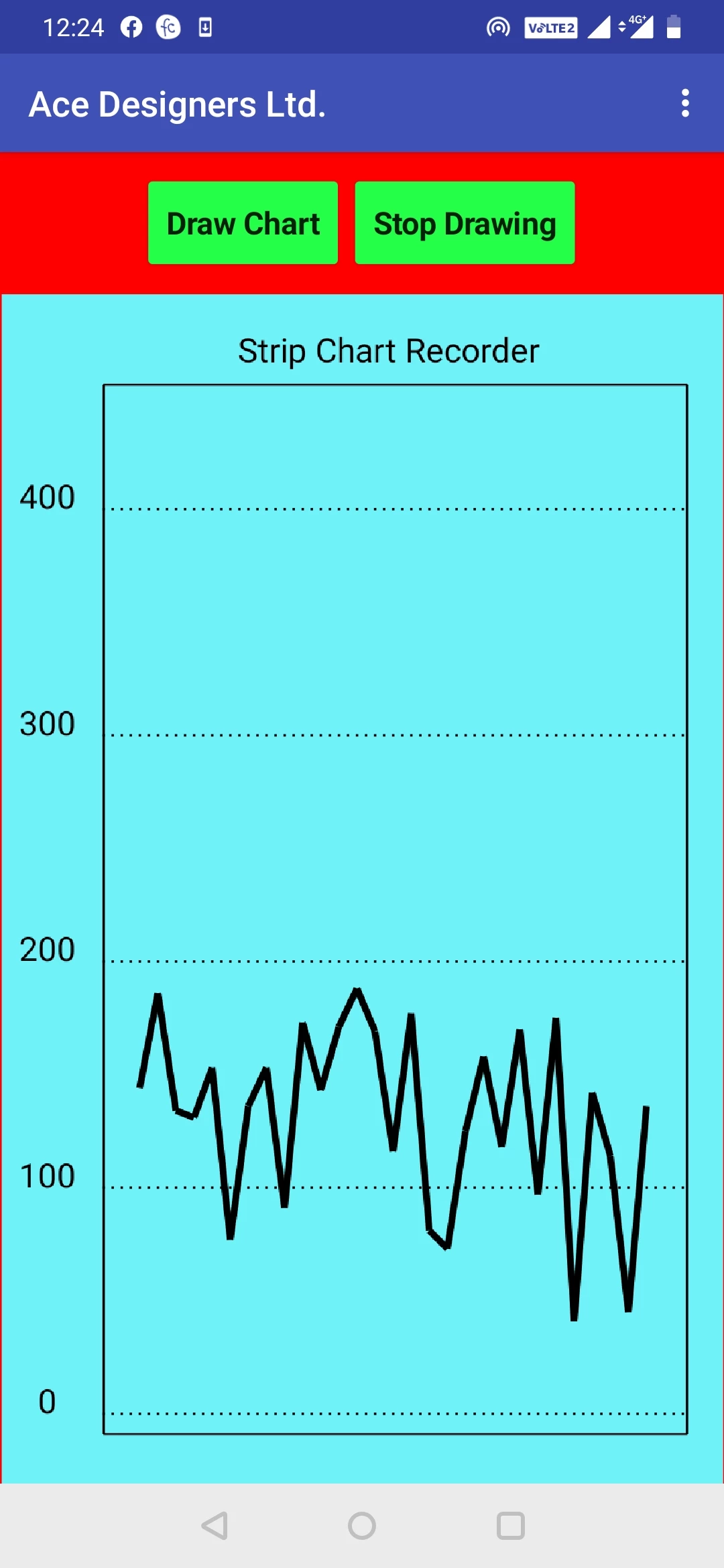

Hi
I'm using STM32F746GDiscovery board.
I'm using STMCubeIDE+ TouchGFX designer for GUI development.
Is it possible to design a Strip Chart using TouchGFX Designer?
If it is possible then please let me know the procedure.
With Regards
Sunil K S
Bangalore​

Could you show an example of a strip chat style you want? Anything is possible :)

Hi Martin,
For example refer the attached image.
Strip chart need to be drawn for the sensor data received at a time interval of 500ms.
Please let me know the procedure to draw strip chart using TouchGFX designer.

There's no support for charts and diagrams or graphs in the designer =) But anything is possible outside of the designer as well.
Search this forum for a simple GraphApplication.zip that i uploaded a while back. It'll show you how to use the Canvas Widget Renderer in TouchGFX to draw a graph.

The best way would be, as Martin has suggested, to download & study the GraphApplication example in the forum. Further, there is a Graph widget available in the TouchGX Open Repository, which can also be a guide for you.
In any case, you will have to get familiar with the TouchGFX framework workings & C++ language. Knowledge of the FreeRTOS will also help.
Start with the TouchGFX designer & the discovery board & download simple examples to the board to get a feel of the framework & then move on to the the example suggested by Martin, along with the Graph available in the open repository.
To achieve what you want, you will have to create your own custom widget to exhibit the behaviour of a strip chart.
