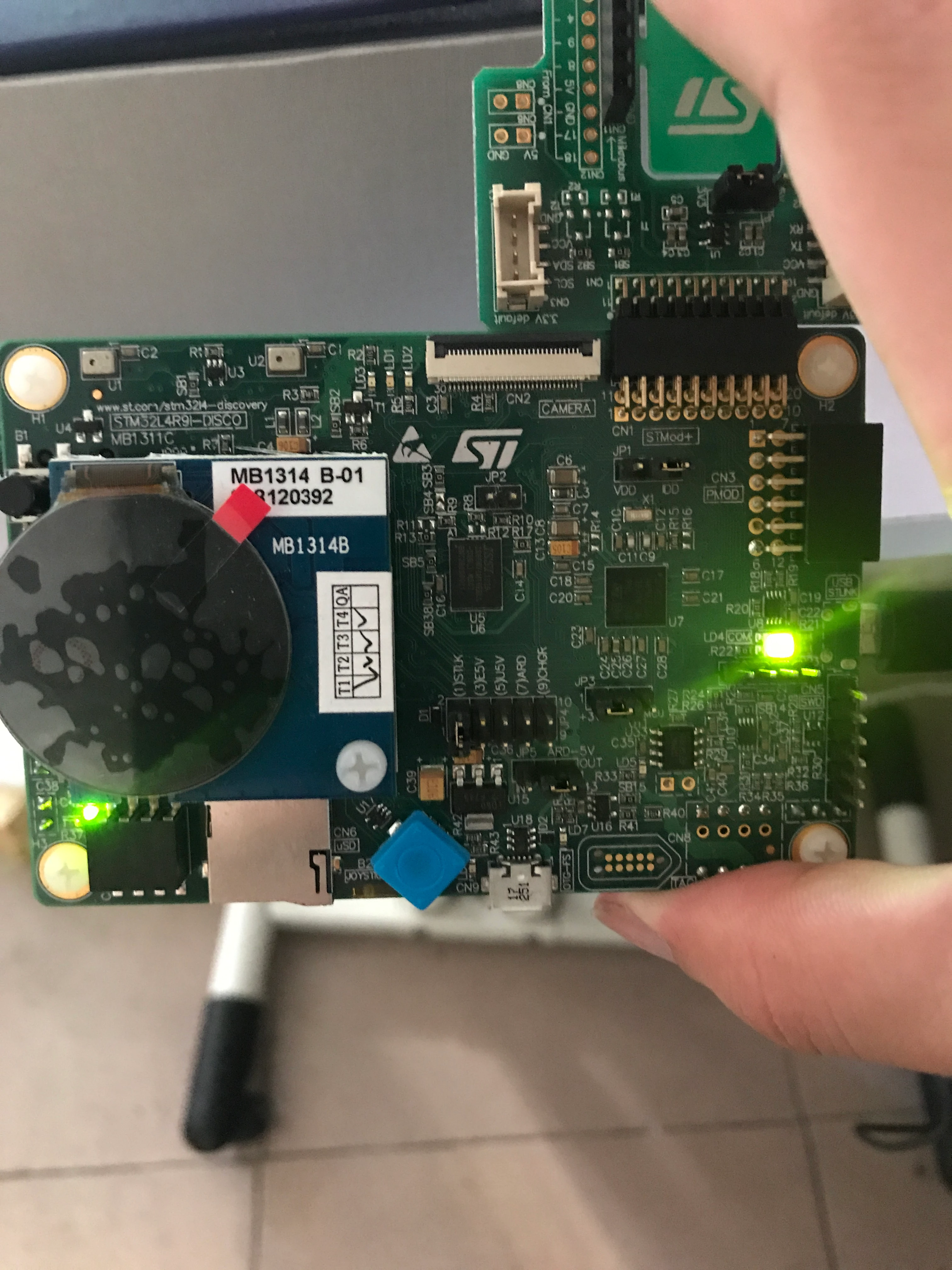

How to down load extern flash MX25LM51245G to 32L4R9I-Discovery?
  • May 23, 2020
  • 5 replies
  • 2705 views
0693W000001pKnTQAU.png0693W000001pKnYQAU.png0693W000001pKnJQAU.png0693W000001pKnEQAU.jpgHi,

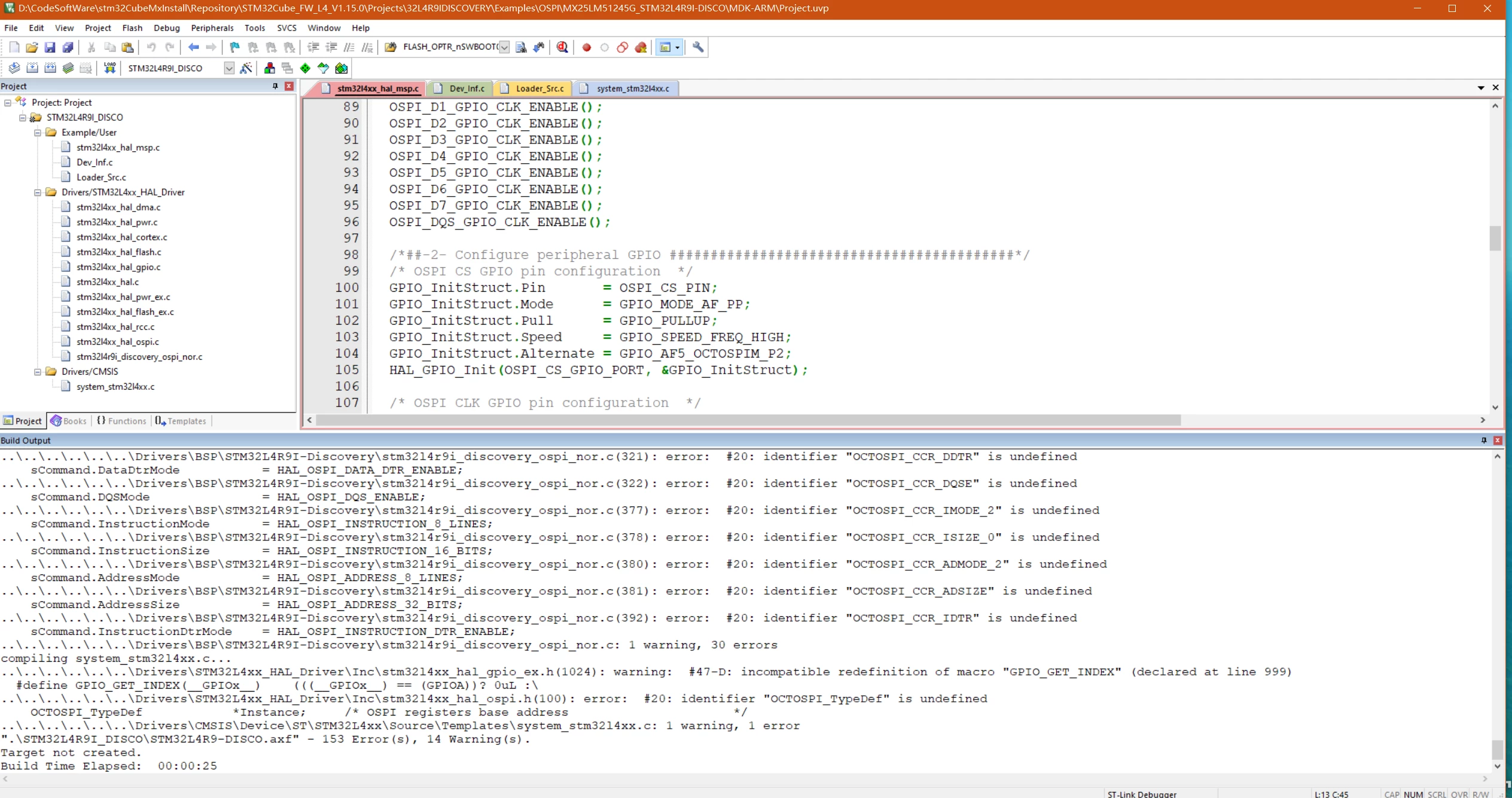

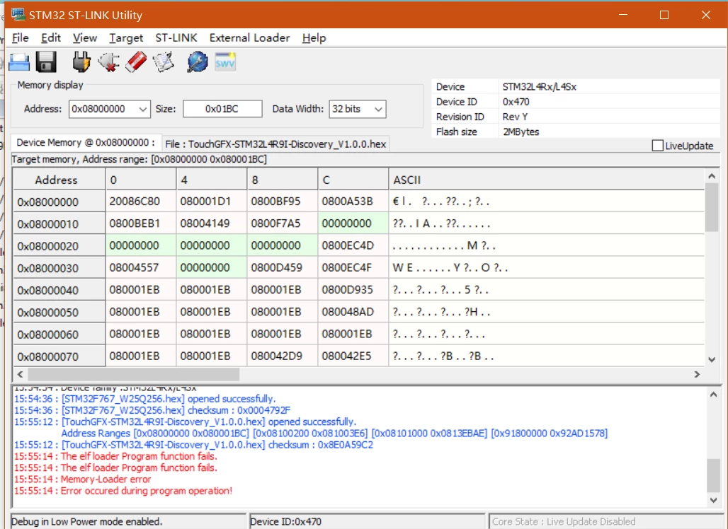

I have a 32L4R9I-Discovery and i want to download Touchgfx demo to it, but when i program Touchgfx hex, ST-LINK Utility report error, i know i neet to download extern flash MX25LM51245G, but i can't find hex on the Internet,so i open MX25LM51245G project and want to program creat hex by Keil5,but when i program the KEIL 5 report much error.
So how can i program MX25LM51245G project to creat hex, or can someone give me MX25LM51245G hex so that i can use Touchgfx demo, the 32L4R9I-Discovery is still not work.:sad_but_relieved_face: .
Thank you very much for all your help!

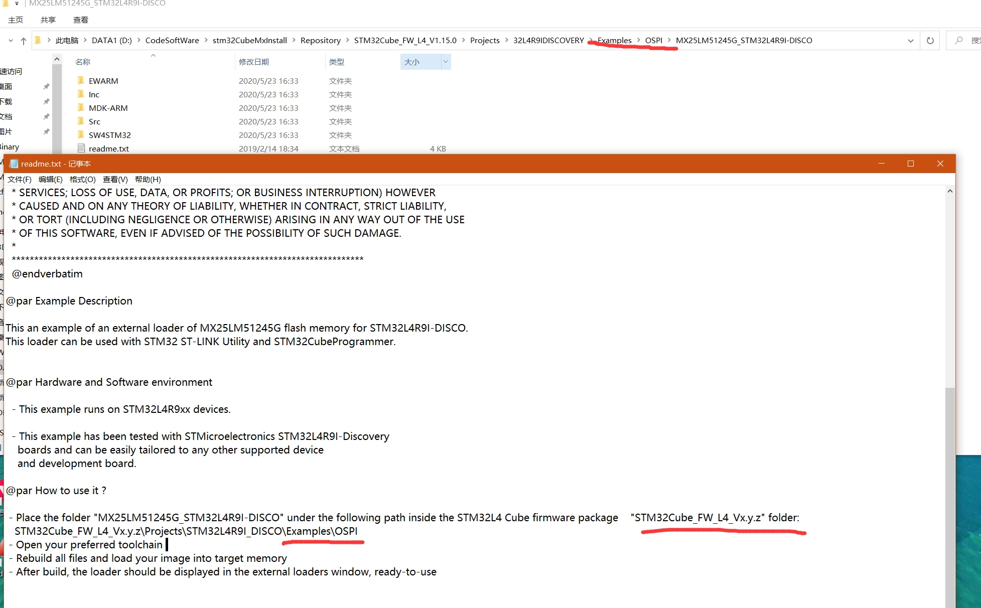

The External Loader code should be pre-built, and selectable under the "External Loader" tab or panes in ST-Link Utilities and STM32 Cube Programmer
STM32CubeProgrammerV2.2.0\bin\ExternalLoader\MX25LM51245G_STM32L4R9I-DISCO.stldr

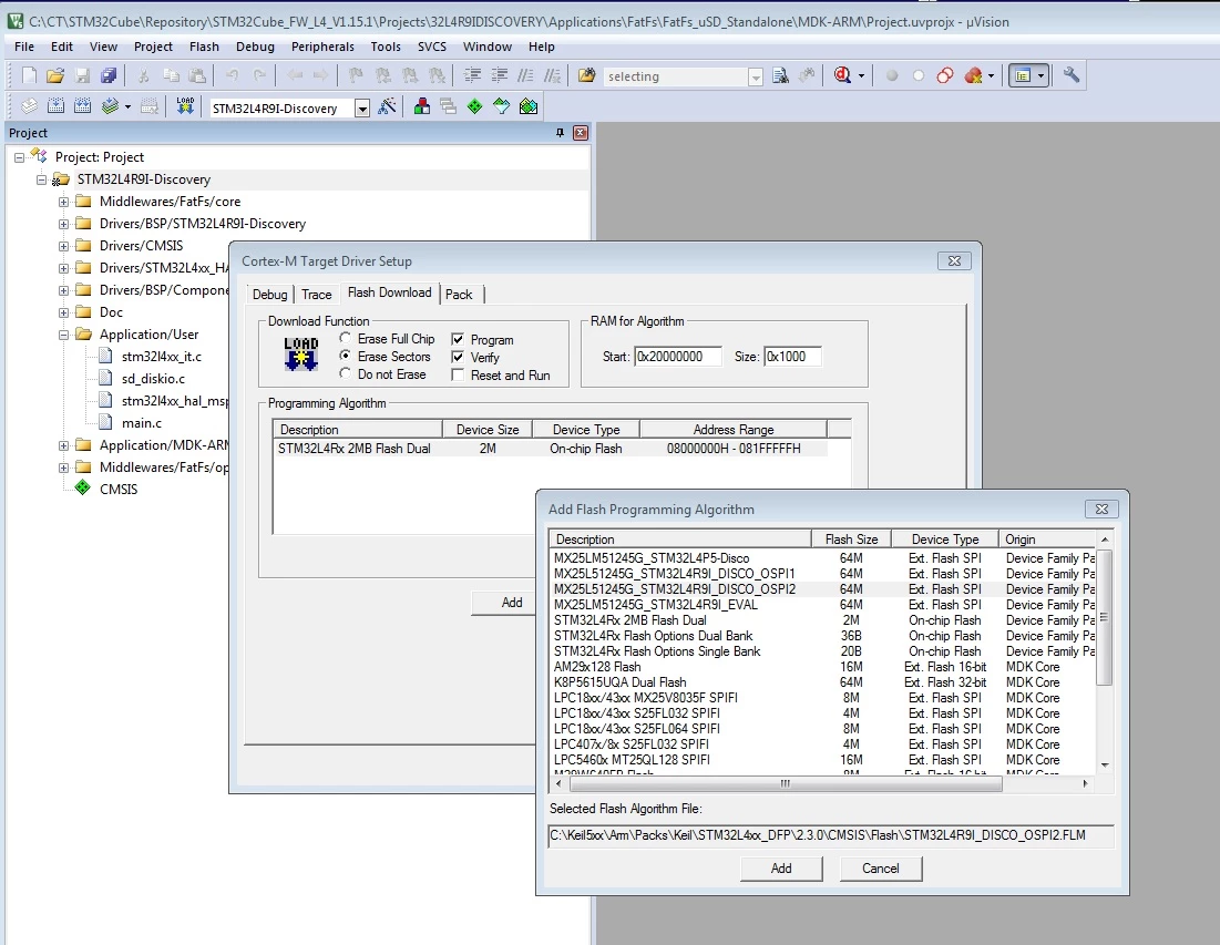

Projects built in Keil should also be directly flashable by picking the Flash Algorithm via the Options -> Debug Settings ->Flash Download Tab

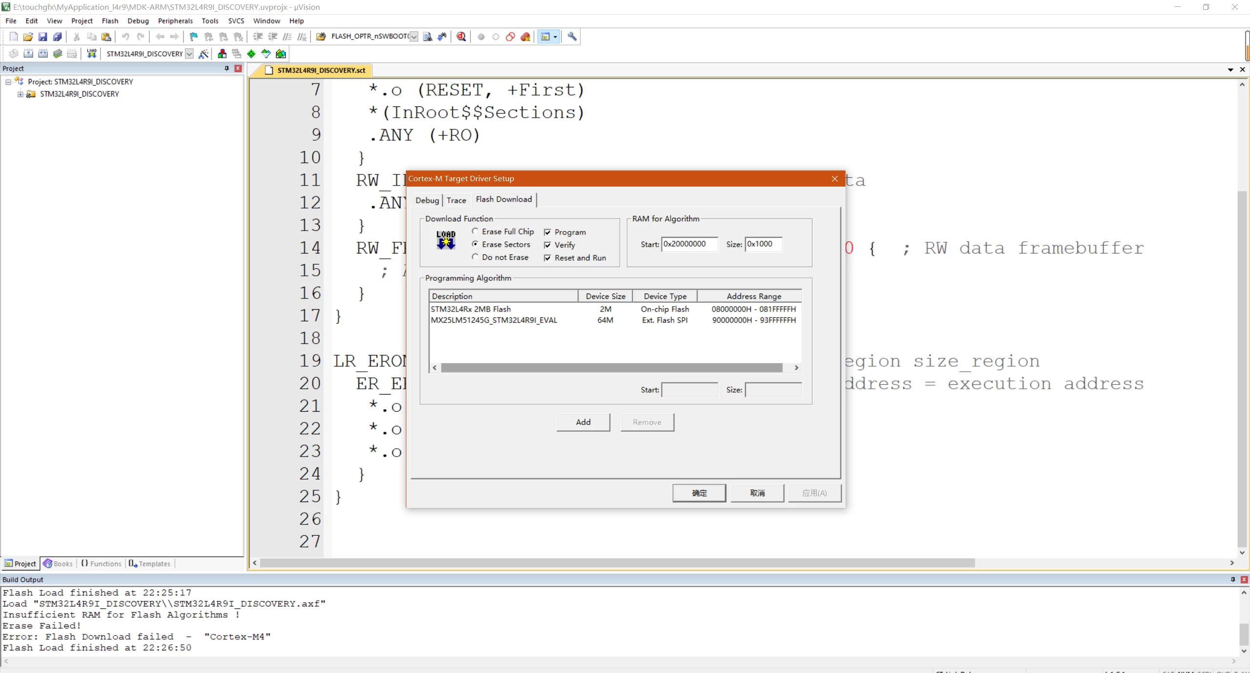

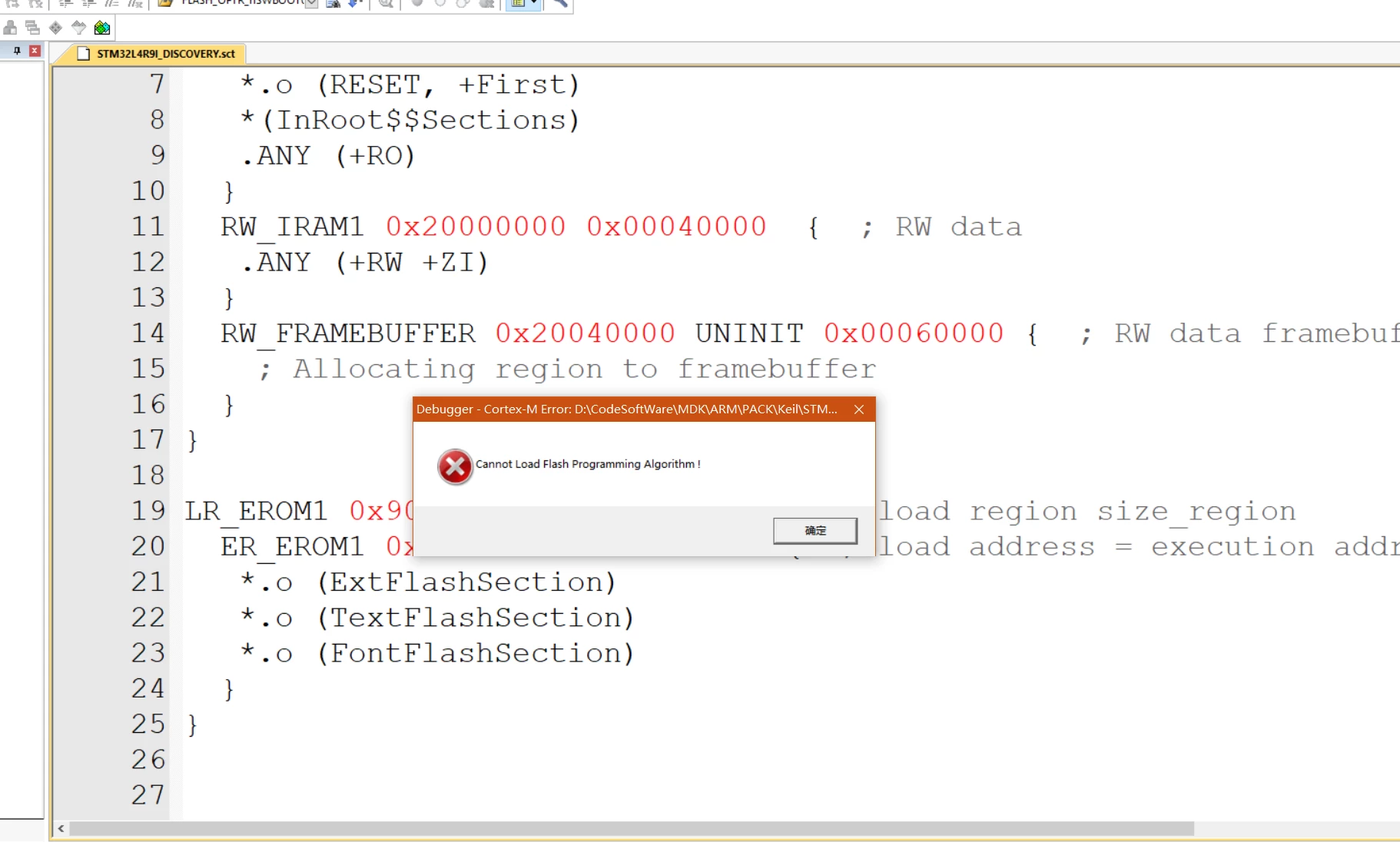

I find the Flash Algorithm in Flash Download Tab,but when i download to it,the Keil report a error:Cannot Load Flash Programming Algorithm.And why do you have so many options in your Flash Download Tab?

Select 0xA000 for the size of the "RAM for Algorithm", the loaders are bigger
