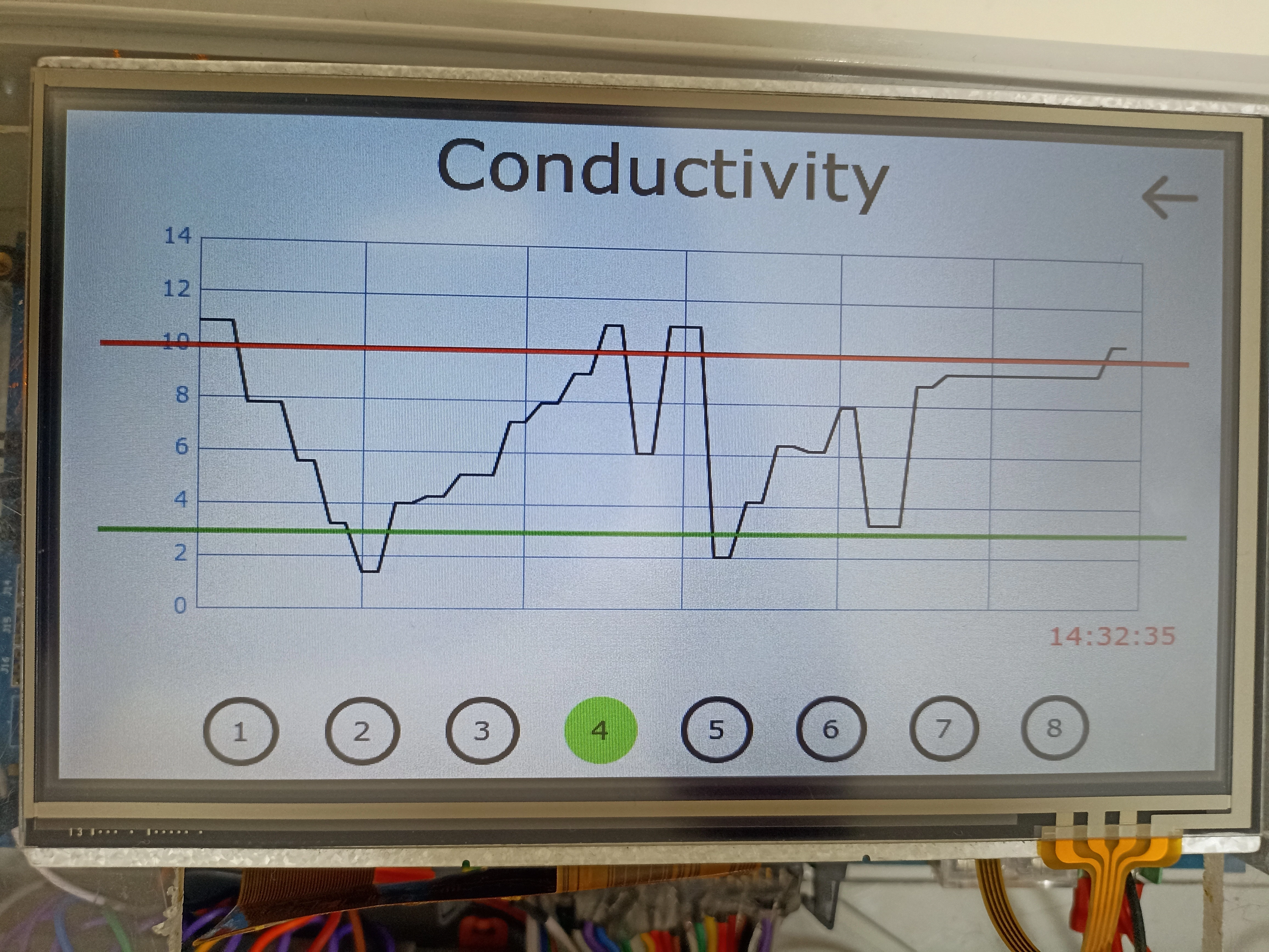

How to Display Time on X-Label in Dynamic Graph
How to Display Time on X-Label in Dynamic Graph instead of incremental integer numbers, I have working RTC date and time which I am displaying on corner of screen. Also my graph is updating as per RTC second update

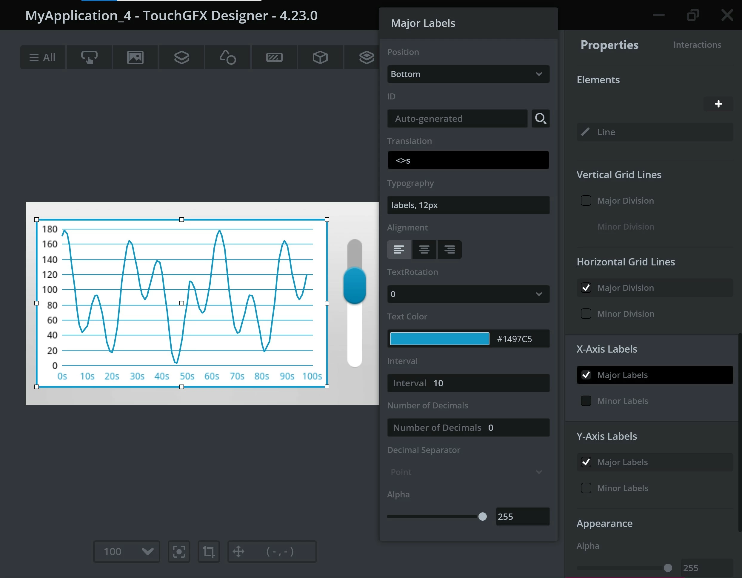

    Hello @Vdoij.1 ,
    Unfortunately, there are no options to have more than one wildcard for the labels. But, you can add text next to values that are shown, for instance, I have added a picture to show how it can be done.
    Add characters to X-labelAdd characters to X-label
     And for updating your graph every second, you can just add a value to your graph in any time interval you want by using the function addDataPoint()

    Thnx for reply,
    I simply remove the X-Axis label and display the time in textarea
