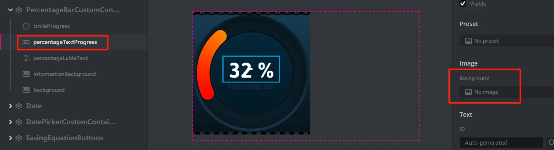

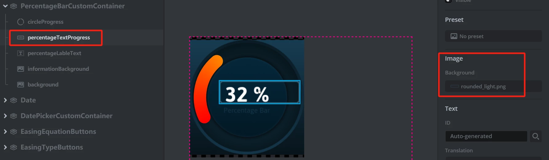

I am trying to copy the TouchGFXDemo1 in TouchGFX Designer.
When I add a "text progress", there is a property of Image for the background.
This property always has an initial image, and I do not know how to delete it.
Could someone tell me how to do it?
I want it like this:
Thanks

    Sorry, I thought it was a text area.
    Text progress inherit from AbstractProgressIndicator (documentation here).
    So it need an image as background.
    If you do not want any image as background, you could simply use a fully transparent image.
    Regards,

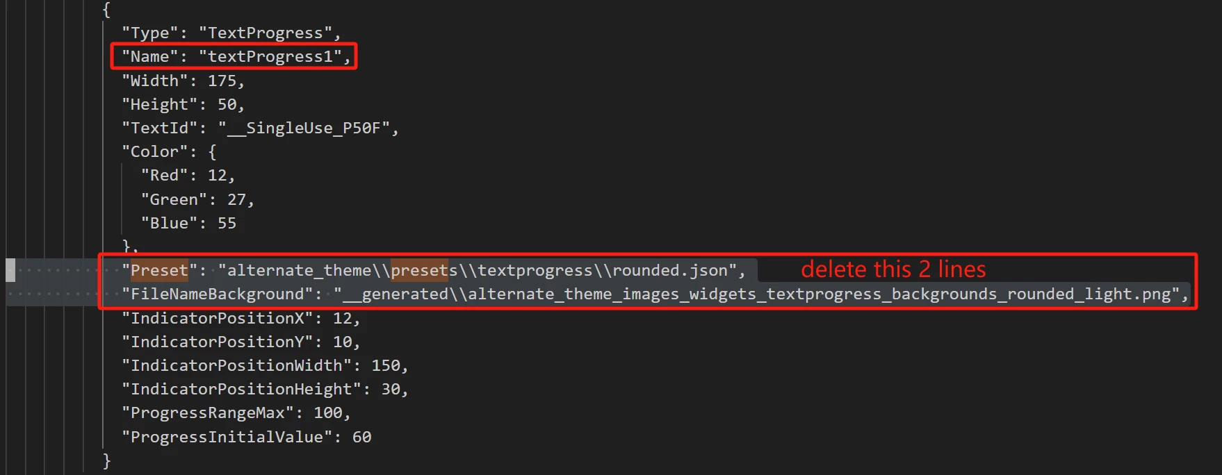

    What I mean is that in the TouchGFX demo, the Text progress can be without the image property.
    But I can't delete it, so I want to know how the demo does it.
    Finally, I found an abnormal solution: delete the property in the .touchgfx file by opening it in text format:
