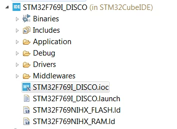

Senior III
April 28, 2020
@Martin KJELDSEN​
There is something strange when creating a project in TouchGFX Designer and then doing a "File->Open Projects from File System" in Stm32CubeIDE.
The Core directory and the TouchGFX directory are NOT included in the Project Explorer of Stm32CubeIDE:
Why is this?
Does this mean one must edit the Core files and the TouchGFX externally and not in this project?
I also notice that trying to Right Click > Go to Declaration on a variable does not take you to the declaration if that file is not part of the project.
What is the proper way to create/import/open a project in Stm32CubeIDE that was created in TouchGFX Designer?
Fabrizio1
Visitor II
April 28, 2020
Hi Scott,
You can find some of the core files in Application->User in CubeIDE, there are the files generated by TouchGFX as well and you can edit the files from here. I think these are shorcuts to the actual files.
Which variable are you trying to access?
I didn't find the proper way to do it yet, but I think this way is working for me.
