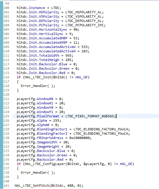

i have done some experiments on 746Disco board. I have configure the LTDC as shown below.0690X00000BwZZLQA3.png
In TOuch graphics i got 20x20 canvas in designer. Then i just plcae a RED colour box i this of dimensions 20x20.

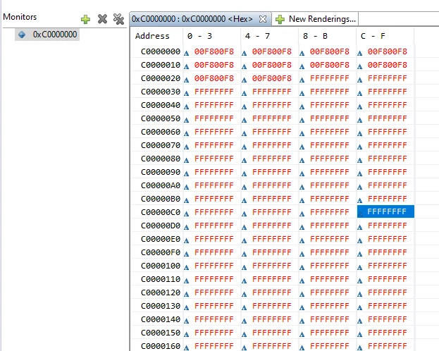

0690X00000BwZZQQA3.pngThen after build project then go to debug in cube iDE it works fine on board a red box is displayed on screen of 746Disco. Then in debug when i check the frambuffer contents these are as shown below.
0690X00000BwZZVQA3.png i have a question now.
it is showing 0x00F800F8 means for one pixels in RGB565 it is 0x00F8. According to me it should be 0xF800 for RGB565. so please clear this one .
For now i am not able do same thing on my custom board. on my custom board i am getting 0x0000 in frame buffer. So means touchgfx is not able to put the content in frame buffer. so what are the possible reasons?

Correct, 0xF800 is Red in RGB565. (Or 0x00F8 because of endianness)
