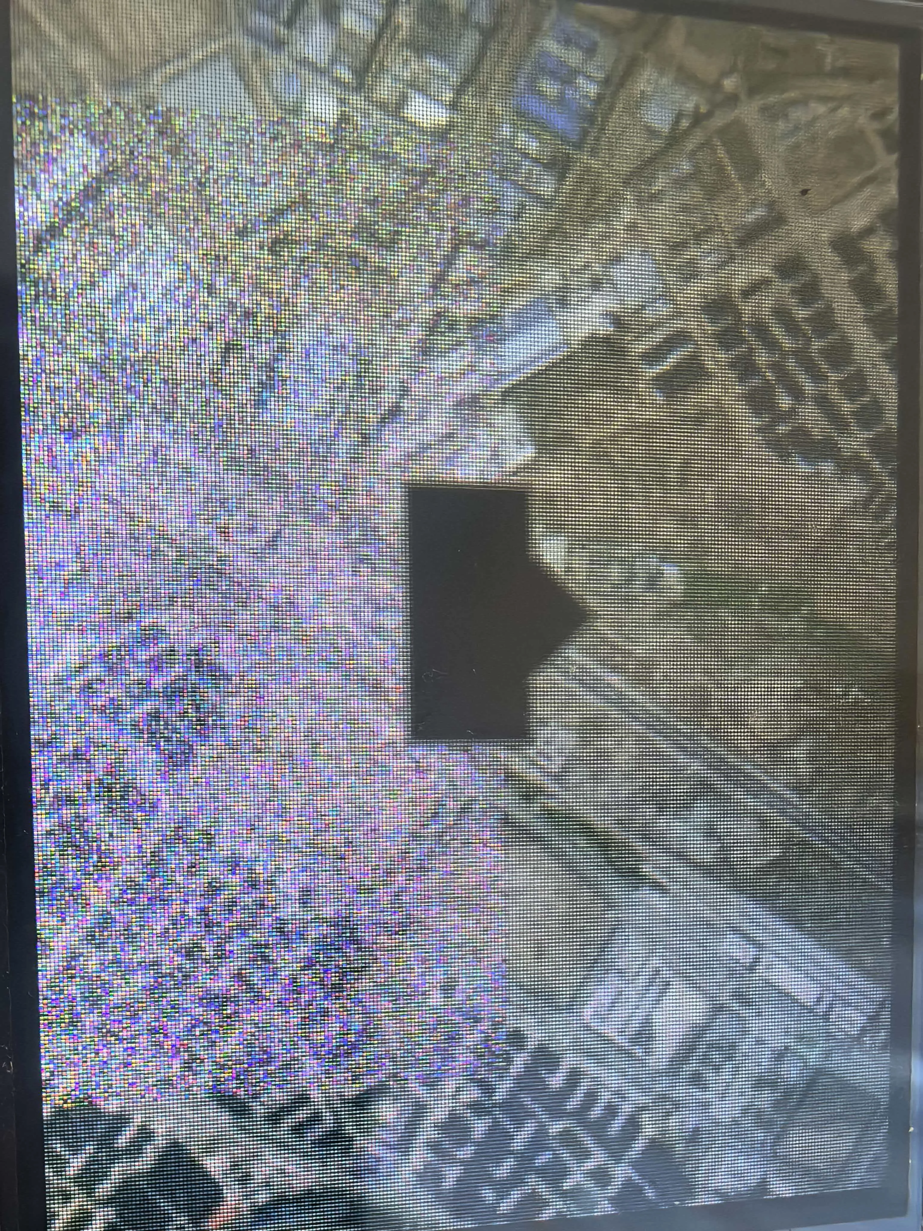

I tried your code,It works but only partly.
Half of the display is good,the other half have random pixels on screen.

I finally make these random pixels disappear,by using  memset()  before render.

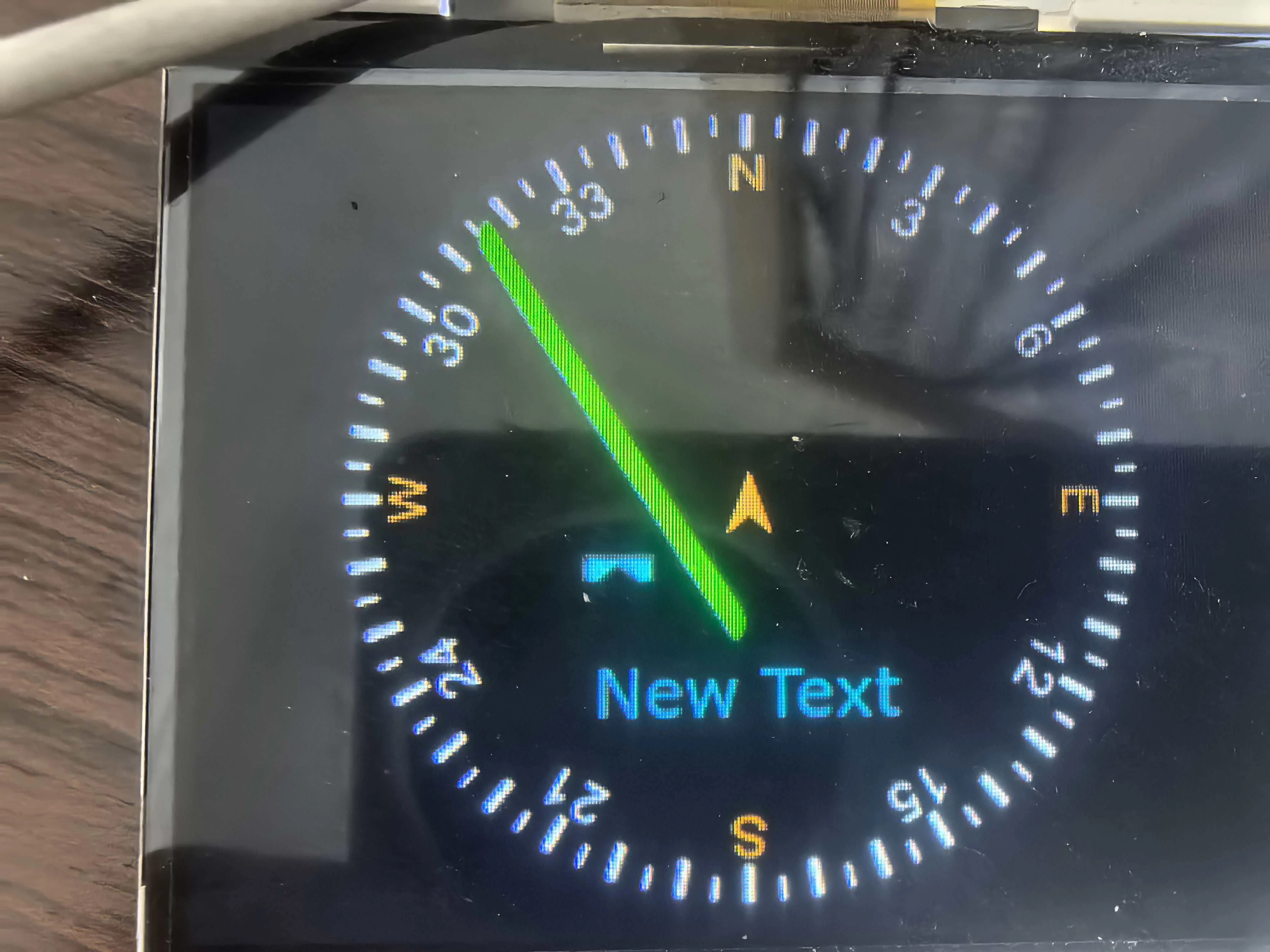

this is what I want:

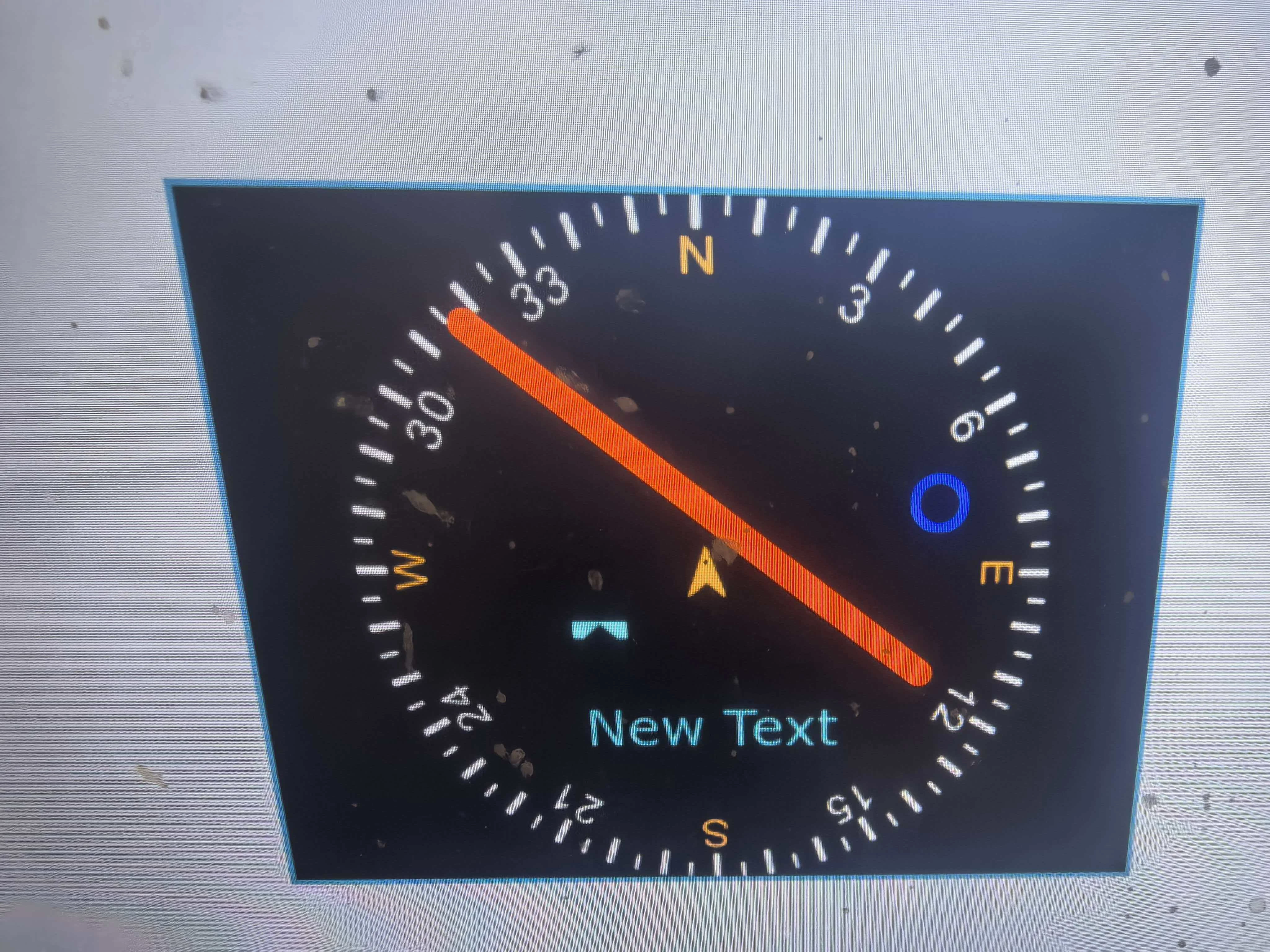

but after download I got this:
if you put a image into the container(using dynamic bitmap ARGB),then it shows correctly,but if you draw a line or a circle,it shows wrongly, and the circle does not draw at all.
Line color changed.Line position and length changed.
Based on these problems,I think there may be some bug in touchgfx core code.
What can I do to make it right?

The reason Canvas widgets do not work is that TouchGFX Designer does not know about your 32bpp LCD class. Therefore, only the default RGB565 painter is generated, and you must manually set a new painter when using ARGB8888.
I have updated and attached the previously shared example with a Line widget.
In Screen1ViewBase.hpp, you can see that TouchGFX generates the following code:
touchgfx::Line line2;
touchgfx::PainterRGB565 line2Painter;
As you can see, this is an RGB565 painter.
To overwrite it, include the following header in your view:
#include <touchgfx/widgets/canvas/PainterARGB8888.hpp>
Then, in e.g. setupScreen, write the following code:
// Modify painter color format for line2
PainterARGB8888 line2PainterARGB;
line2PainterARGB.setColor(touchgfx::Color::getColorFromRGB(0, 255, 30));
line2.setPainter(line2PainterARGB);
The reason not all painters are always generated is to limit code size. However, this results in this less optimal solution when Canvas widgets are used in a dynamic bitmap with a color depth different from the framebuffer.
