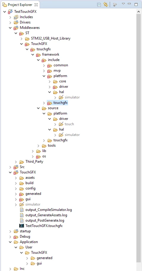

May 28, 2019 10:10 AM UTC
Below my project structure :
How to have the TouchGFX library in the linker ? I followed the best answer of the following topic step by step and I think having the same configuration as them now.. but with the errors of the log.

Martin KJELDSEN
Principal III
May 28, 2019 10:58 AM UTC
I don't have Atollic installed, but it's probably the same as CubeIDE since they're both eclipse based. Go to your top level project folder and choose properties. Then choose "C/C++ General" and you should have tabs to input library and library paths - input "Middlewares/ST/TouchGFX/touchgfx/lib/core/cortex_m7/gcc" as the librath path and "touchgfx-float-abi-hard" as the library
Martin KJELDSEN
Principal III
May 28, 2019 11:00 AM UTC
It seems you already have the gui and generated folders in your project. Are you sure it's a C++ project? Otherwise you'd get linker errors since no cpp files are considered for compilation.
Also seems there are a lot of issues for other folders, probably due to missing include paths.
ALuca
ALucaAuthor
May 28, 2019 1:57 PM UTC
Thank you !
the project build by following the best answer of the topic below + Adding touch GFX library as you explained.
https://community.st.com/s/question/0D50X0000Ap0bTUSQY/use-touchgfx-410-with-cubemx-52-and-atollic-93-on-f769-disco-boardhow-to-get-it-compiling-workingis-there-a-working-example-project-ioc-fileis-there-a-step-by-step-manual
Now I have a project built in Atollic with a fixed screen.
