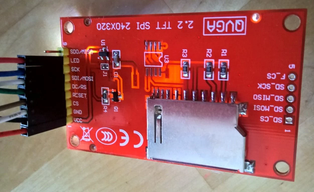

How to control LCD display brightness?
  • February 27, 2020
  • 2377 views
I am searching how to control such displays brightness?
I assume I need to pass less than 3.3V to LED pin? How do I pass less volts?
2 replies
Tesla DeLorean
Guru
February 27, 2020
Perhaps the vendor has a manual or examples?
You could try using a PWM signal
alister
Senior III
February 27, 2020
Googled 'qvga 2.2 tft spi "240x320"'. Lots of hits. Very popular. Looks cute.
From its schematic you'd see the controller does the PWM.
Controller is ILI9341 or ILI9340.
From the datasheet's table of contents:
8.2.38. Write Display Brightness (51h).......................................................................................... 141
8.2.39. Read Display Brightness (52h).......................................................................................... 142
8.2.40. Write CTRL Display (53h).................................................................................................. 143
8.2.41. Read CTRL Display (54h) ................................................................................................. 145
8.2.42. Write Content Adaptive Brightness Control (55h).............................................................. 147
8.2.43. Read Content Adaptive Brightness Control (56h) ............................................................. 148
8.2.44. Write CABC Minimum Brightness (5Eh)............................................................................ 149
8.2.45. Read CABC Minimum Brightness (5Fh)............................................................................ 150
You'd send the commands via the SPI.
Comprehensive post about it at https://www.instructables.com/id/Cheap-TFT-22-inch-Display-on-Arduino-ILI9340C-or-I/.
