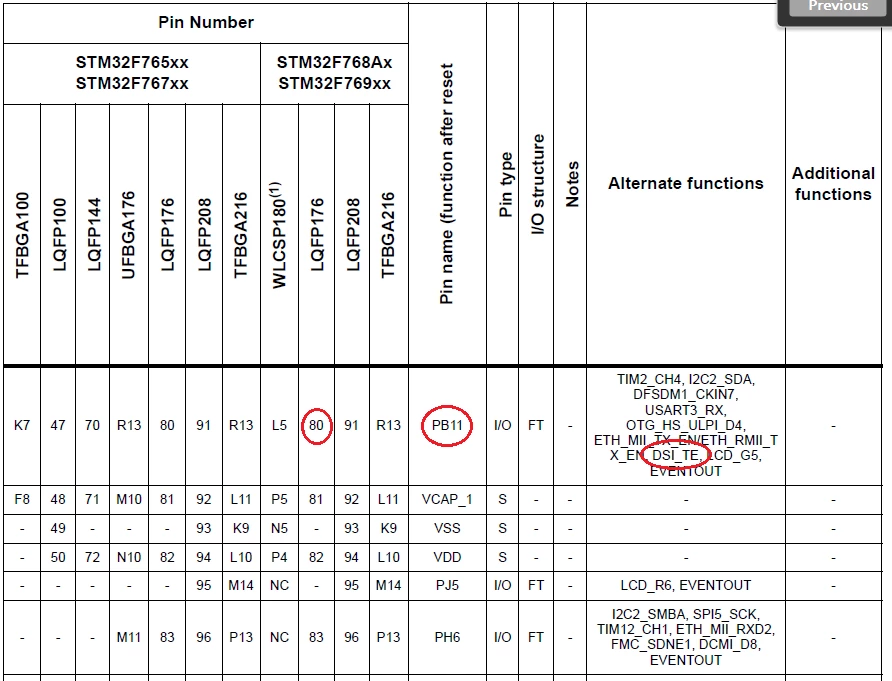

were using  B-LCD40-DSI1 daughterboard on STM32F769I-EVAL evaluation board and moving from TFBGA216 package to FQFP176 package (with DSI).
Im unable to find where to connect DSI_TE and DSI_RESET pins.
Thank you
2 replies
ZMohd.7
December 12, 2018

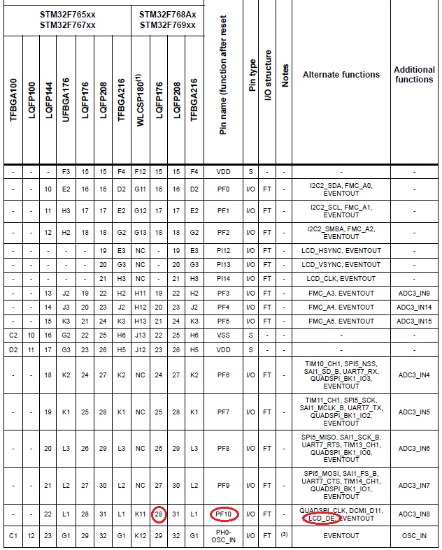

Please go through the attached screenshot, for DSI_TE & DSI_RESET should be connect with Pin PB11 & PF10 Respectively in case of STM32F769IITx or LQFP176 package.
Hope it will help you.
