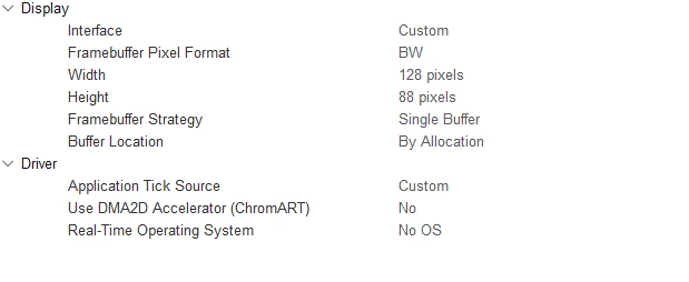

For the purposes of a project, I have a board driven by an STM32F746ZET6, which communicates with an LCD screen (C12864WO from Newhaven Displays) driven by an ST7565P. Communication with the display is via an FMC.
I manage to display pixels on the screen directly via FMC communication. But now I'd like to use TouchGFX to ease the creation of the graphic interface with TouchGFX Designer. And that's where it gets tricky.
The screen is rather atypical for TouchGFX. It's monochrome and the resolution of the 8080 parallel interface is 8 bits. TouchGFX can handle FMC, but only for 16-bit.
What's more, the pixel arrangement is not like on other screens I've seen so far. GRAM is made up of 8 pages which divide the screen into 8 lines 128 pixels long by 8 pixels high. When I send 8 bits via FMC, instead of filling 8 bits horizontally as on other screens, the screen fills the 8 bits in the first column of the first page, before moving on to the next column.
So I'm trying to adapt the code for this rather special display. Based on the information on this page (unfortunately very 16-bit screens oriented): https://support.touchgfx.com/docs/development/touchgfx-hal-development/scenarios/scenarios-fmc
I need to be able to manipulate the framebuffer and I don't understand at all how it's arranged. I've configured STM32CubeMX for a resolution of 128x64 pixels, with a color depth of BW (so logically 1 bpp).
But in the code, the framebuffer is managed by a uint32_t array of (((128 + 7) / 8 ) * 64 + 3) / 4 elements. And the getTFTFrameBuffer() function returns the same array cast to a 16-bit pointer (uint16_t*).
Could you help me make sense of this?

I suggest you use a similar approach...

TouchGFX works with a 16-bit buffer, no matter if Framebuffer Pixel Format = BW is set it should sync with the display buffer when there is a change.
its address is taken with the function
TouchGFXGeneratedHAL::getInstance ()->getTFTFrameBuffer ();
As a reminder: If B/W Display is used, there must be at least 1 shape in one of the screens for it to work !!! Otherwise it gives an error-
identifier "LCD1bpp" is undefined TouchGFX\target\generated\TouchGFXConfiguration.cpp 35
I hope this bug has been fixed by now

Aug 21, 2023 9:26 AM UTC
I'm sorry, I'm not sure to understand all of your code. The framebuffer of TouchGFX might be the same on both of our sides, but how is implemented the framebuffer for SSD1306 (the one you get by calling getBufferData()) ? I see it's a uint8_t array, but how is it organized ?
For the shape, I've already added a Box shape so I have a white background to see the foreground elements (otherwise, the background is transparent and I see nothing in simulator).
Senior
Aug 21, 2023 11:25 AM UTC
Since in a B/W display every 1 bit is a pixel (8 pixels per byte), 16-bit pixels have to be converted to 1-bit pixels. if the pixel value is 0x0000 (black) the recorded pixel is 0 otherwise it is 1.  It's a bit more complicated with OLED because the pixels are arranged vertically. Maybe that's why the code is a bit confusing...
else getBufferData() returns the pointer to the display buffer 1024 bytes ((128x64) /8). Which is thrown every time by SSD1306.update();.This function sends the entire display buffer to the display controller.
I am deliberately not posting the SSD1306 driver. Because it inherits several library classes. Which will lead to more misunderstandings.
Aug 22, 2023 8:46 AM UTC
I ended up testing your code as is, adapting a bit (both my code and yours), and in the end it works fine. I'll have a look at how to clean it up, because I'm not sure everything's clear on my side. Anyway, I'm switching the subject to Solved, your solution is perfect! Thanks a lot!
