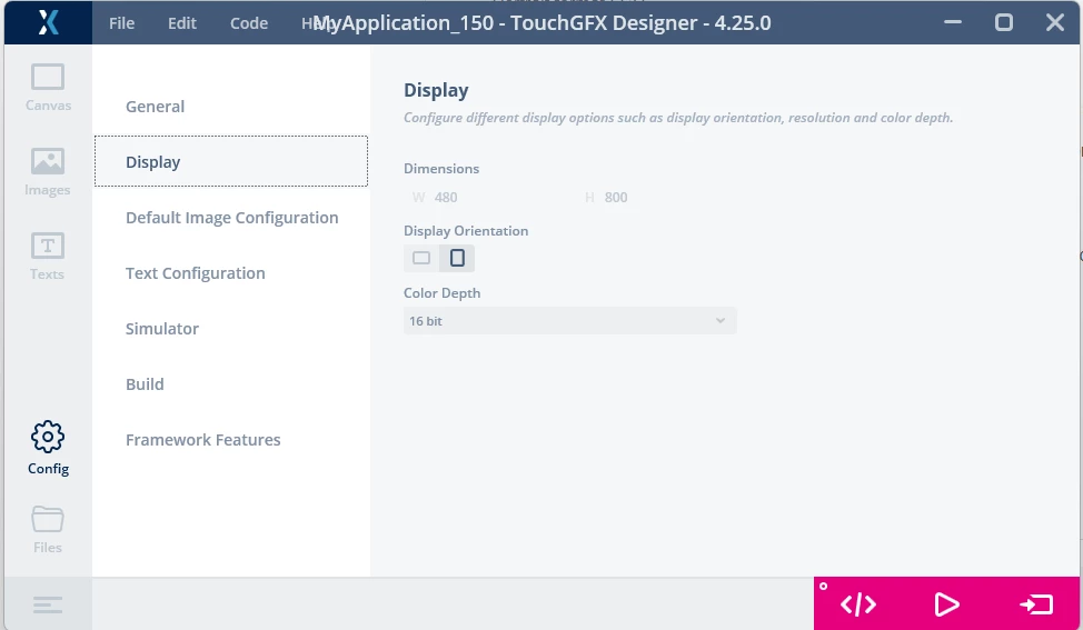

I created a design file in TouchGFX with the following configuration:
  • Portrait format LCD
  • Interface: RGB
  • Display Orientation: Portrait
I would now like to use this design file with a different LCD that has the following specifications:
  • Landscape format LCD (rotated 90 degrees to be used in portrait orientation)
  • Interface: RGB
Both LCDs have the same resolution.
Are there any specific settings I need to adjust in TouchGFX to make the design compatible with the new LCD?
1 reply
September 11, 2025
First, you should make sure that your LTDC parameters (clock, porches and so on) match the specifications for your new display in CubeMX.
Regarding the change in oritentation, you should be able to handle this by setting the correct screen orientation in Designer, as shown in the screenshot.
