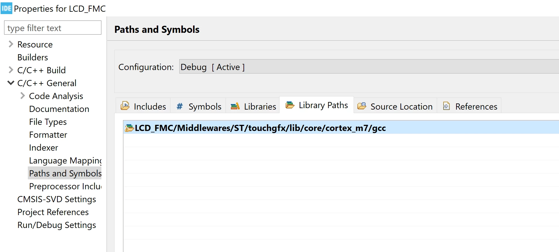

Alexandre RENOUXBest answer
Visitor II
Sep 8, 2020 9:40 AM UTC
You library path was incorrect, you need to change it. I suppose you modified your project name and therefore the lib path was lost.
Also, after this I still had issues because you don't have enough internal RAM for an entire framebuffer.
If you look at the .ld file in STM32F746ZGTX_FLASH.ld
You only have this written :
MEMORY
 RAM (xrw) : ORIGIN = 0x20000000, LENGTH = 320K
 FLASH (rx) : ORIGIN = 0x8000000, LENGTH = 1024K
However, to store a framebuffer 800x480 with 16 bpp you need 480x800x2/1024 = 750KBytes > 320 KBytes
You need to add external RAM otherwise you cannot do much.
/Alexandre

Hi again,
I created a fmc setup and a single background image via touchgfx but it gives compilation error as " cannot find -l:libtouchgfx-float-abi-hard.a " and I couldnt resolve the issue. I attached all files.
Could you please help me to display this simple "hello world" task?
Thanks

Sep 8, 2020 6:34 AM UTC
How can I solve the error?
