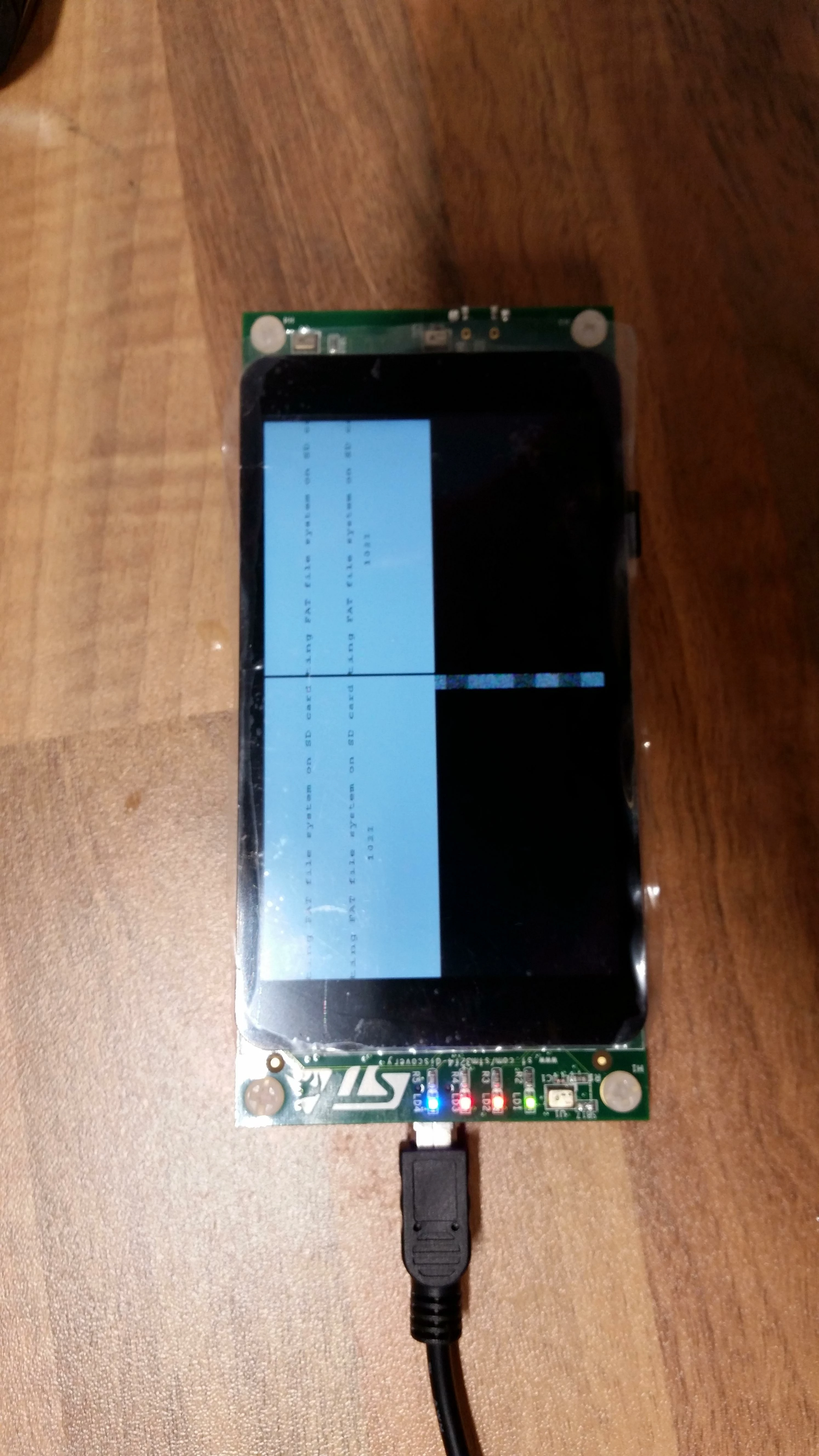

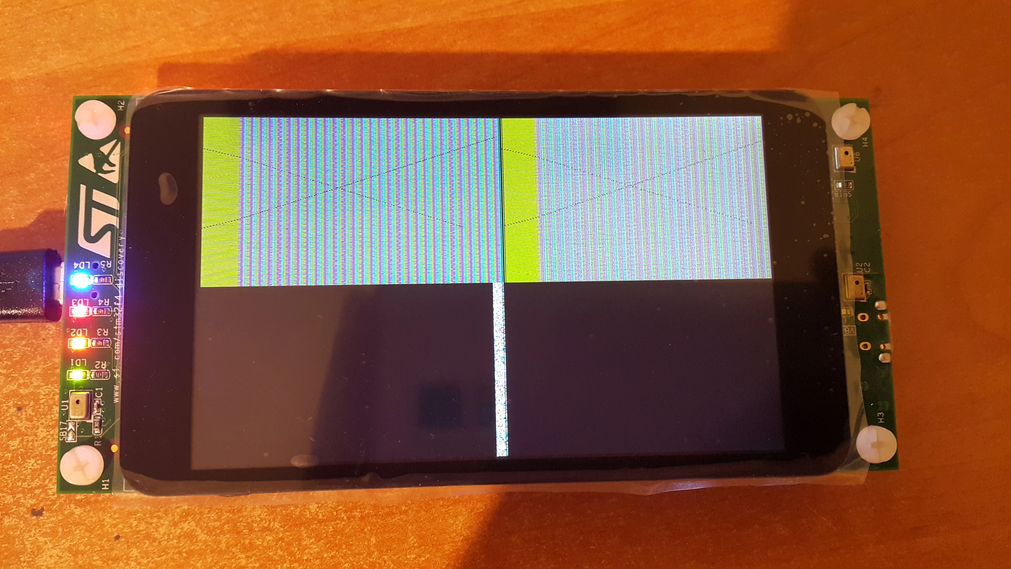

I'm hopelessly trying to configure CubeMX to enableLCD TFT on STM32F469i-disco board (bought recently if that matters). The best effect so far is the following:
What I did:
1. Used CubeMX to generate configuration with all peripherials configured
2. Switched off all I did not need (for instance the RTOS, USART etc.)
3. Selectively copied BSP drivers from the CubeF4 examples. I added all dependencies (components, fonts), such that project builds correctly
4. I try to draw cross through the whole screen, important part of the main.c follows (I stripped comments to improve clarity):
int main(void) { HAL_Init(); SystemClock_Config(); MX_GPIO_Init(); MX_CRC_Init(); MX_DMA2D_Init(); MX_DSIHOST_DSI_Init(); MX_FMC_Init(); MX_I2C1_Init(); MX_I2C2_Init(); MX_LTDC_Init(); MX_QUADSPI_Init(); MX_SAI1_Init(); MX_SDIO_SD_Init(); MX_TIM1_Init(); MX_FATFS_Init(); BSP_SDRAM_Init(); BSP_LCD_InitEx(LCD_ORIENTATION_LANDSCAPE); BSP_LCD_DisplayOn(); BSP_TS_Init(800,480); BSP_LCD_LayerDefaultInit(0, 0xC0000000); BSP_LCD_SelectLayer(0); BSP_LCD_DisplayOn(); BSP_LCD_Clear(LCD_COLOR_DARKCYAN); BSP_LCD_SetTextColor(0x00000000); BSP_LCD_DrawLine(0, 0, 799, 399); BSP_LCD_DrawLine(0, 399, 799, 0); while (1) { } }
This is the best effect I could achieve, at least the lines are visible, but obviously this is not what I'm counting on.
I attached the CubeMX configuration file to this post. I'm kinda new in microcontroller programming (a background with Arduino only), so I have no clue, what might I misconfigured. As the source is really simple, I guess, there's something in CubeMX, that I have misconfigured or not configured, but I'm running out of ideas. I looked at the CubeF4 demos, but they lack CubeMX configuration files. Also, I failed to deduce from the sources, how to configure the LTDC in CubeMX.

I'm having the same issues with the STM32F469I-DISCO and CubeMX-generated code. After setting up all BSP files and getting the project to compile without problemsI got a very similar output on the LCD.The text is a little blurry but readable. I'm also outputting the ADC value on the screen here.
I'm also new to STM32 and lack ideas how to solve this issue. Mybe a clock source is configured incorrectly? This is still a section I left untouched after it was generated by CubeMX, although after verifying it roughly, it should be fine...
Actually the solution to this problem should not be too difficult since all settings for the interfaces and the LCD controller are in the BSP files. Making changes to the LTDC inside Cube doesn't affect anything. Wondering where exactly cube interferes here....Any suggestions would be highly appreciated.

If you try to draw something colorful, you'll notice the same effect as in my case. Try to fill screen with solid color like 0xff0000ff - you will notice, that it cycles through RGB - like the value you chose had invalid size (and someone took like 24 from 32 bits. In this case the flickering also can be easily seen.
It looks like some kind of timing problem for me, though I have no idea on where to seek. I spent some time blindly changing parameters of layers, LTDC, DMA2D, but usually with no effect. Is there anyone at all, who succeeded in configuring the STM32F469I with BSP and LCD? This is really weird, that we independently got stuck in exactly the same situation.

Sorry to dig up this old thread but I ran into the same issue, and wasted a couple hours scratching my head before figuring out it was a LTDC clock issue.
Anyway to fix this, set PLLSAI N multiplier to 192, /R to 7 and the subsequent divider to 2. It gives you a 27.428571MHz LCD-TFT clock and then your LCD works like a charm.
BUT be aware that it will ruin your 48MHz clock and SAI-A clocks. If you need the 48MHz clocks (USB, SDIO) simply change PLL48CLK Mux to PLLQ, set the PLL N multiplier to 144, and /Q to 6.
It would have been nice if ST added more granularity to the PLLSAI dividers so we don't loose nearly 40MHz core clock to keep the 48MHz clock running.
