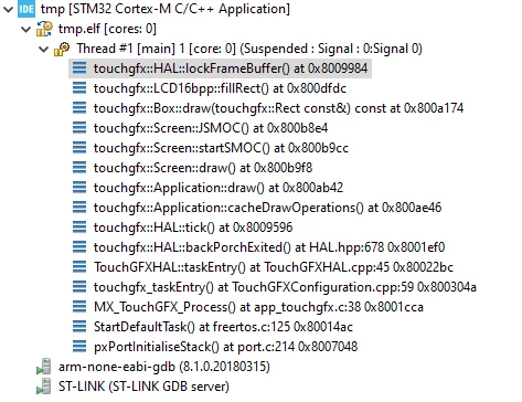

this code stoped in point -> No source available for "touchgfx::HAL::lockFrameBuffer() at 0x8009984"
function lockFrameBuffer() realised in static library touchgfx or need redefine this?

Please check my project.

I fixed this issue. I configured my project with "custom" graphic accelerator. But I changed configuration to DMA2D and my project successfully work.
