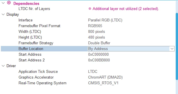

How to config 2 layers LTDC by useing CUBEMX for TOUCHGFX? CUBEMX warning me additiona layer layer not utilized when i config LTDC 2 layers

TouchGFX doesn't use the second layer, that's all the message implies. You can use it for something else if you want, but TouchGFX uses Layer 1. Unfortunately we cannot do just a "warning" in the ui, but when you generate code CubeMX will ask you if you're okay with the active "warning" before generating code.

thx for the answer ,then i still have a question,​ if touchgfx uses layer 1 which is the bottom layer on lcd,then i show a picture on top layer,that will override what touchgfx shows,is there way to make touchgfx shows on top layer?
