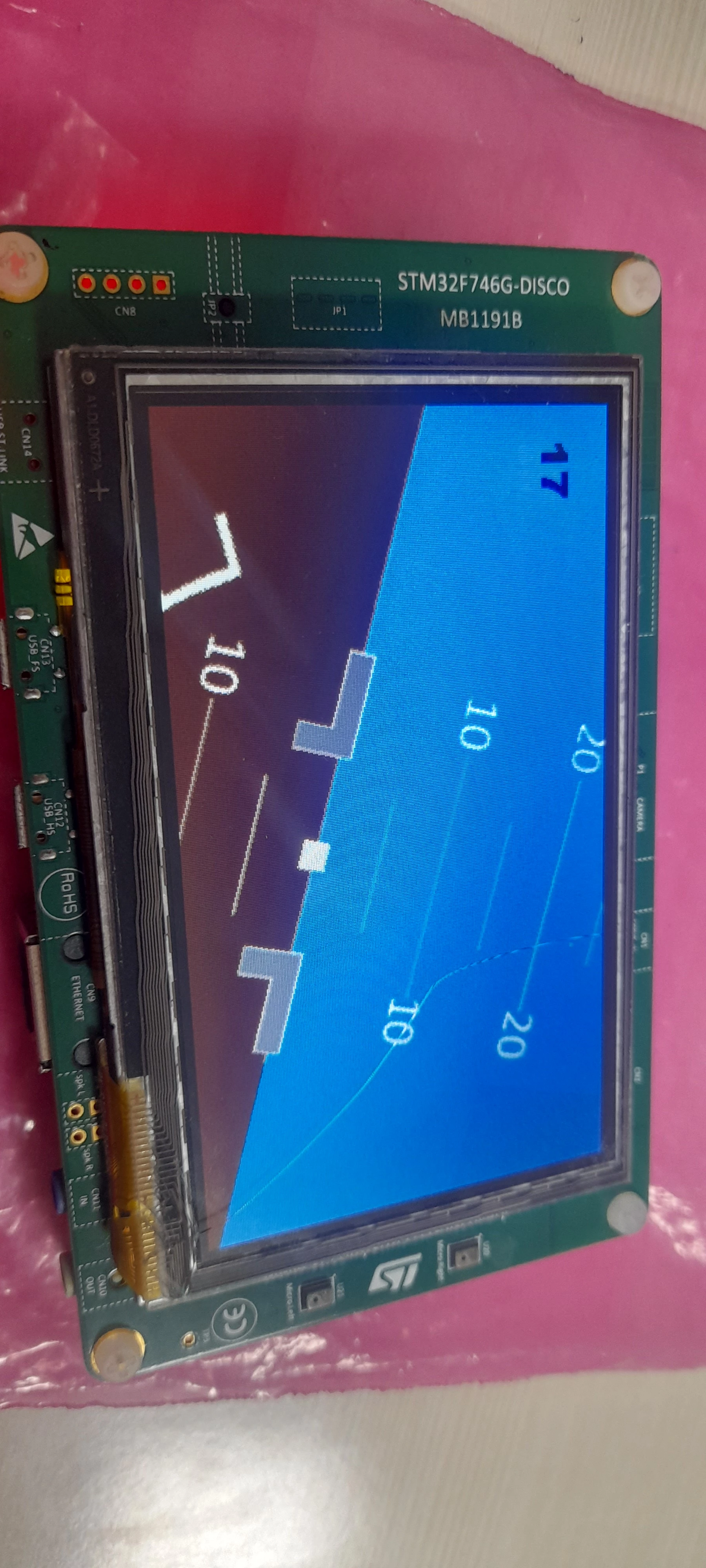

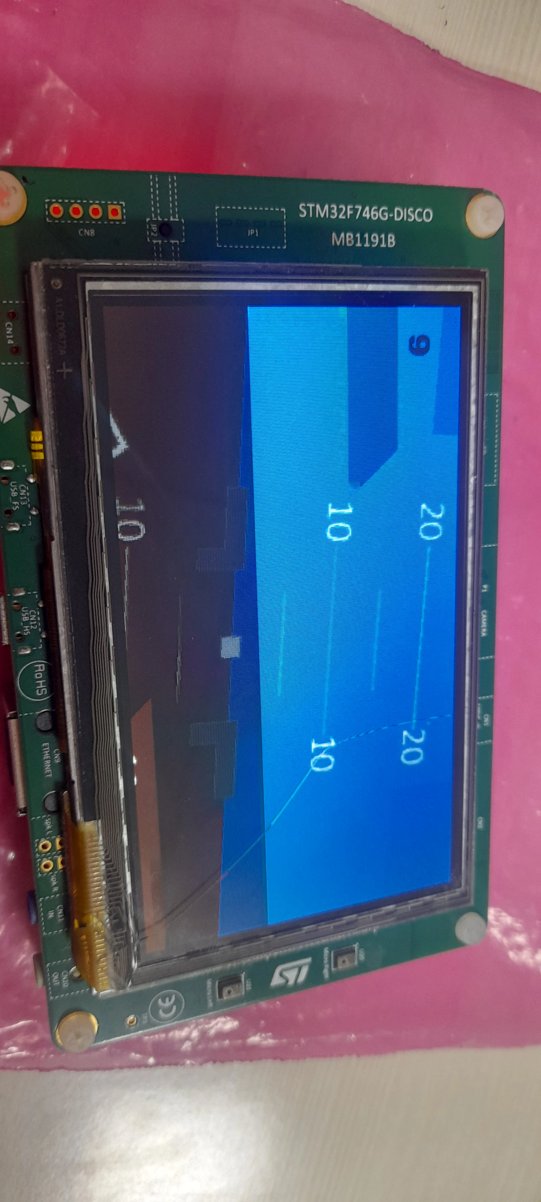

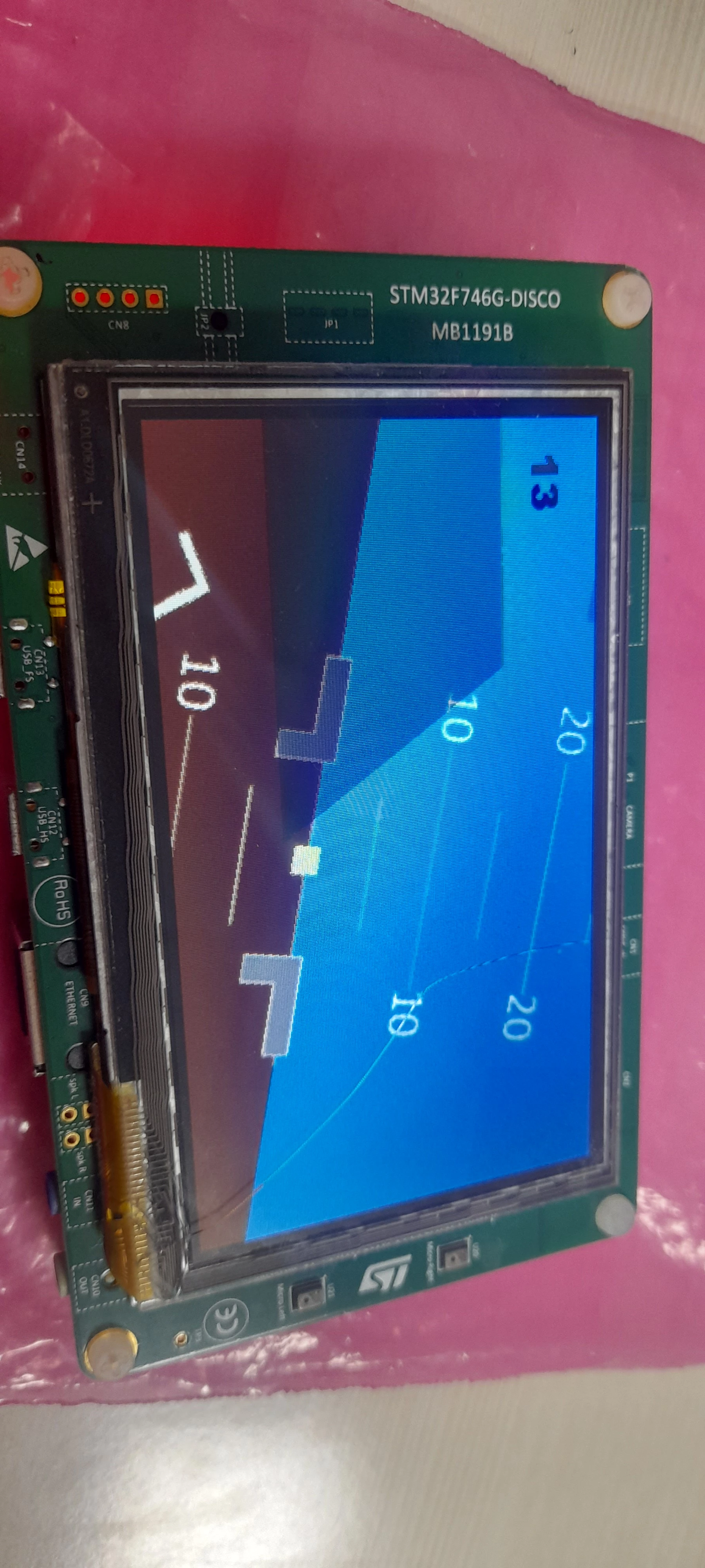

    I have changed the values repeatedly in foreground through TextArea, while the image is tilting in the background.
    But it is worked fine in Simulator, but  I am getting some disturbance image while I am trying  to display in the STM32F746G Discovery Board. I am unable to load the simulated image in the board when the foreground values are changing and the image is moving in the background simultaneously...

    Could you share some video or screenshots of the problem ?

    Which kind of Framebuffer strategy are you using ?
    Single, Double or Partial ?

    Hii,
    I am using Single Framebuffer.
